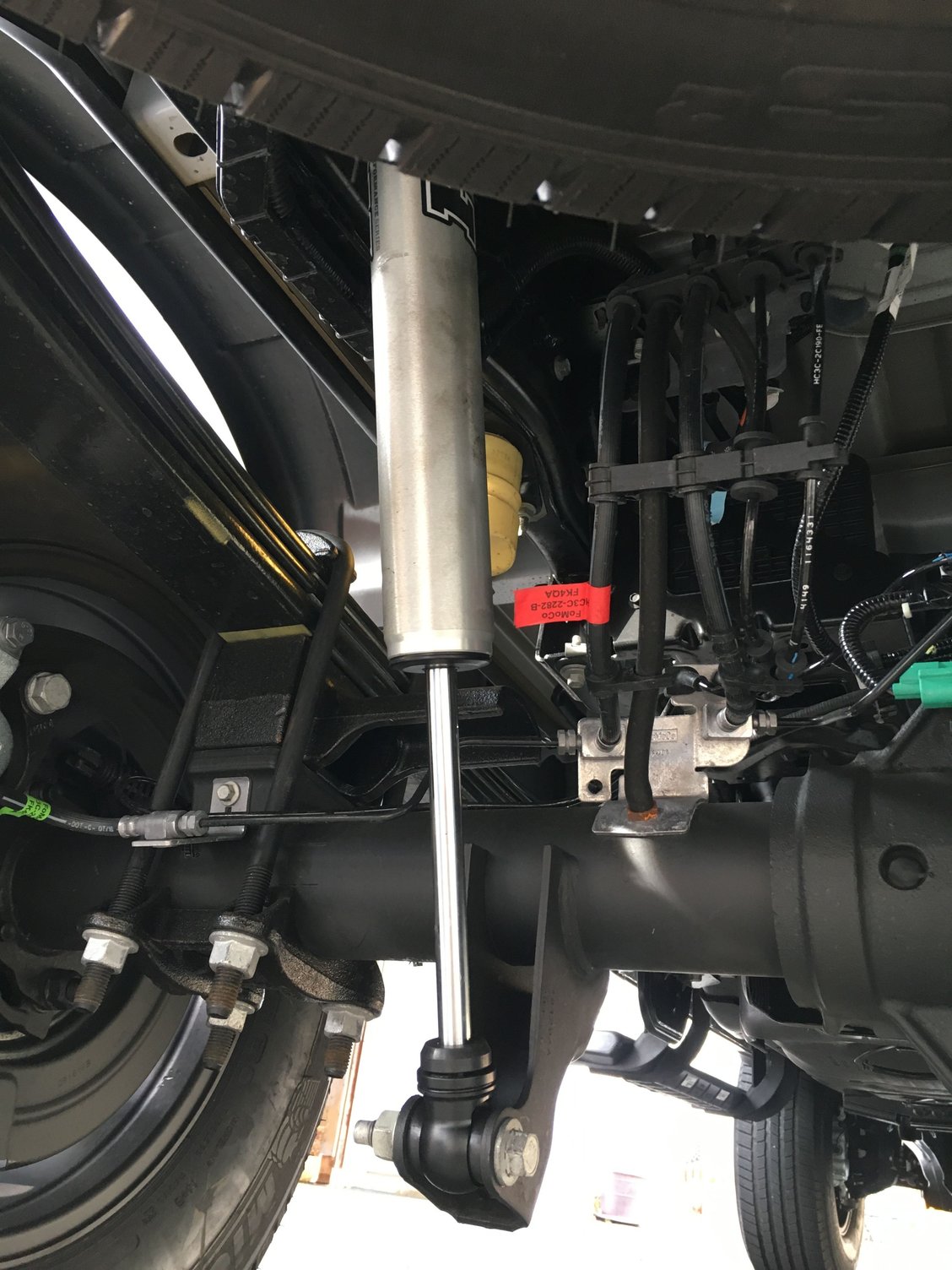

what is the change on the '17 shocks vs the '16?
i have heard one of the rear bushings has changed. i called Fox, they said it was the front bushing, i told them i heard the rear, then they weren't sure. at any rate they gave me the part numbers for the correct size bushing and sleeve.
can anyone confirm which bushing needs to be changed ?

Rear for certain. I believe its the lower bolt if I remember correctly...and if Im not mistaken, the shock bolt is smaller on the 17's and you have to install a different bushing. We did mine back in early October so it's a challenge to remember every detail.

The fronts are the same as 16's
The Rear are different dadz34 is correct. Stage 3 has the FOX 2.0's BDS rear shocks in stock with the new bushings ready to go. Here's there number for the rear FOX-98224717
Front number with 2 - 3 " lift 980-24-646-2

is the bds emblem just a sticker on the shocks or is it painted?
if an emblem, can it be removed without removing the rest of the fox emblem?

You could remove the BDS decal if wanted but it's a fox sticker.

looks like all one piece

Cut the BDS part off with a blade ..LOL
You can't even see the decal on the rears, the frame rails hide it unless you climb up under the truck.
