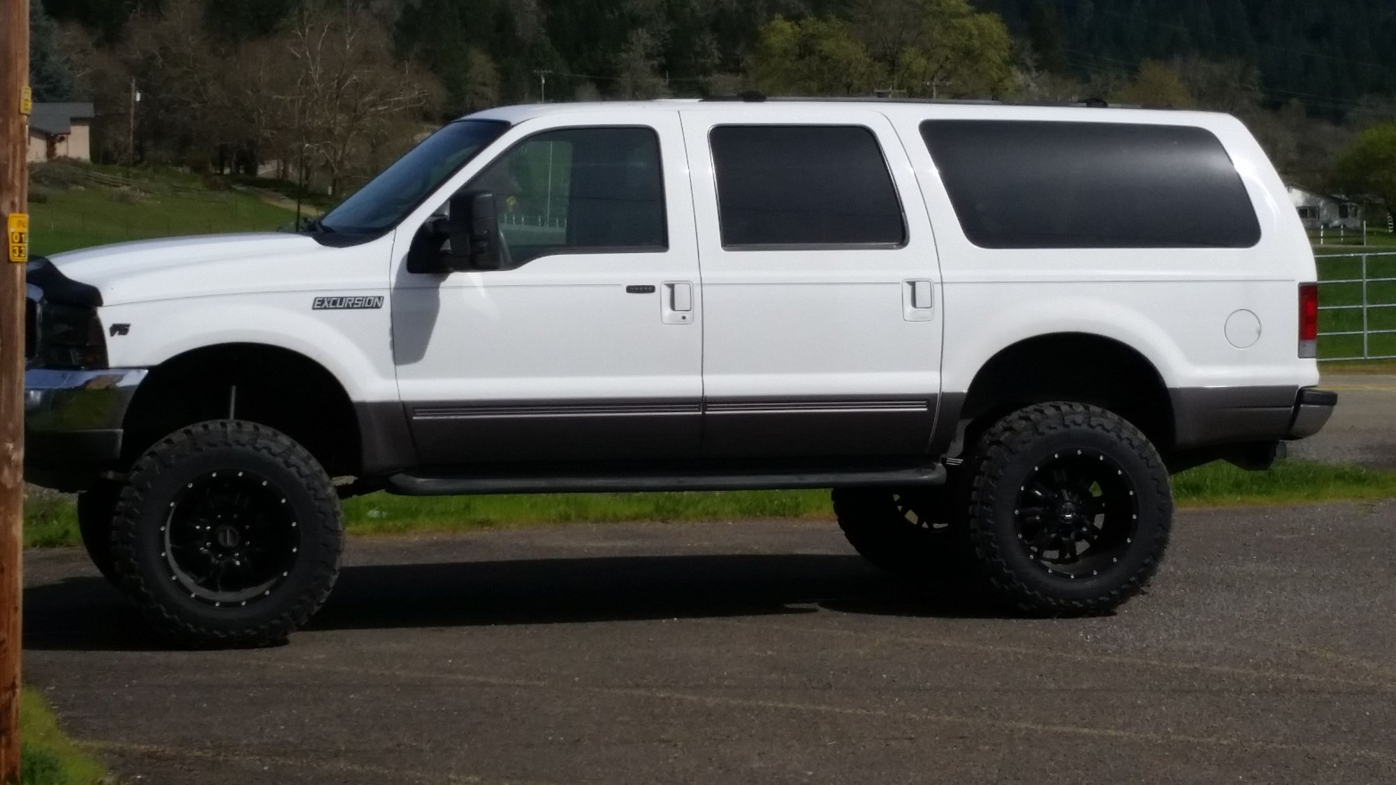

I figured you all might like to see how it ended up.
As it started, 27 inches from center of hub to fender on the front. 24.5 inches in the rear.
Kinda hard to see on the trailer but the rake is still there. Even with motor trans installed and full of fluid.
So I ran the same front springs with a 3.5 mini pak. The rear got 4 inch Pro-Comp springs on the factory block. Pro-Comp Pro Runner shocks all around. Drop track bar bracket, extended sway bar links, and drop pitman arm finish it off.
I installed the 3 inch block in the rear to level it out. Here its 32.5 front and 32.5 rear. Minor trimming on the front valance. Barely rubs when turning into the driveway. I have plans to get the 4 inch springs for the front and take most of the mini pak out of the front. Then a 4 inch block for the rear to just give it one more inch of clearance.
Thank you all for the help. Hope you all like it as much as I do.
