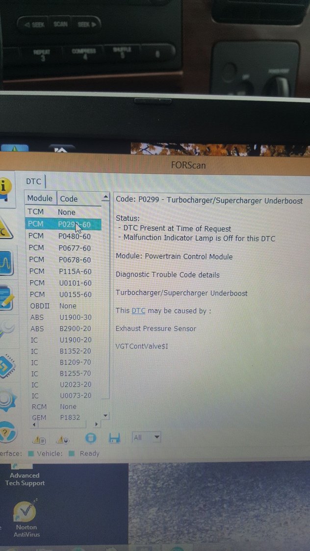

Update: got forscan did the injector buzz test (twice). Didn't show any faults. The only alarming one was the boost was under pressure (p0299). So it's not showing any fuel problems. Could it be a bad sensor or dirty turbo? I know it has a vgt system instead of a normal waste gate. So i read to really get on it to try to keep the viens from sticking and I've done that (plenty of times) here's all my codes
Old Feb 8, 2017 | 03:24 PM
Tideman's Avatar
Tideman
Joined: Nov 2008
Posts: 1,443
Likes: 9
From: South Alabama
Try cleaning your EBP sensor and tube first.
Old Feb 8, 2017 | 04:44 PM
mjcxking's Avatar
mjcxking
Joined: Feb 2017
Posts: 8
OK will try that. The other thing is my turbo seems to build boost fine. When really getting on it it will build around 35-40 psi.
