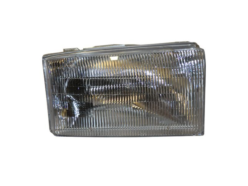

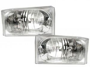

Originally Posted by nstubbert
I don't know if I have the fluted or crystal. How do I tell the difference?
By looking at them
Fluted:
Crystal/non-fluted:

I have crystal
