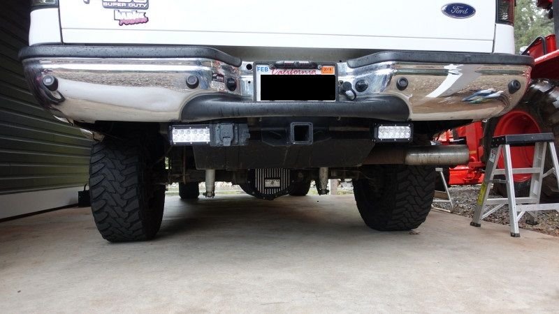

These are on an '02. I just installed these as the last set failed.
I like the profile of these as it allowed me to mount them up high and out of the way. My previous set were square and hung down lower.
These were under $40 on Amazon. Nilight 2PCS 6.5" 36w Flood LED

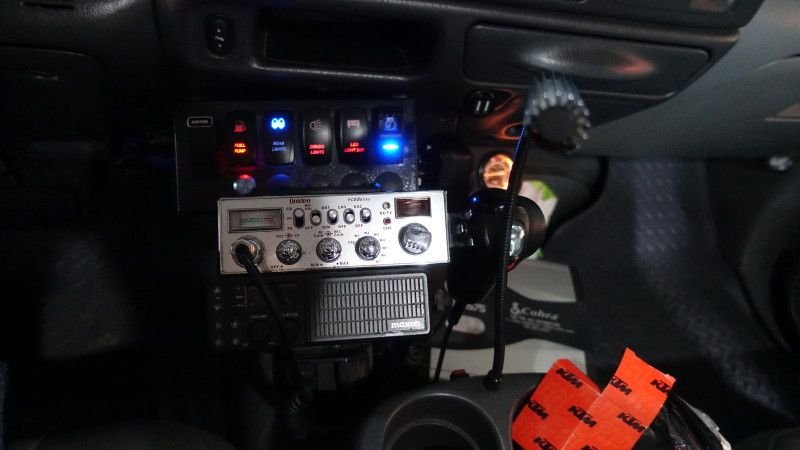

I ran separate switched power to them as I use them regularly without the truck in reverse. Also they are so bright I want to avoid blinding people in parking lots where I really don't need the extra light.
Back in '02 we had to come up with our own Upfitter Switch solution...
When I get my new truck I plan to use one of the surface mount solutions mentioned above and run them off one of the Upfitter Switches.
