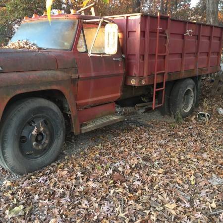

Does this appear to be 4x4 then? I'm new to the whole MD trucks thing.

Looks like a standard straight axle hub to me, not a drive axle. Drive axle:
https://s-media-cache-ak0.pinimg.com...c805639cfa.jpg
This is an image showing the locking/unlocking type hubs:
http://www.dennysdriveshaft.com/app/...charger-2A.jpg
