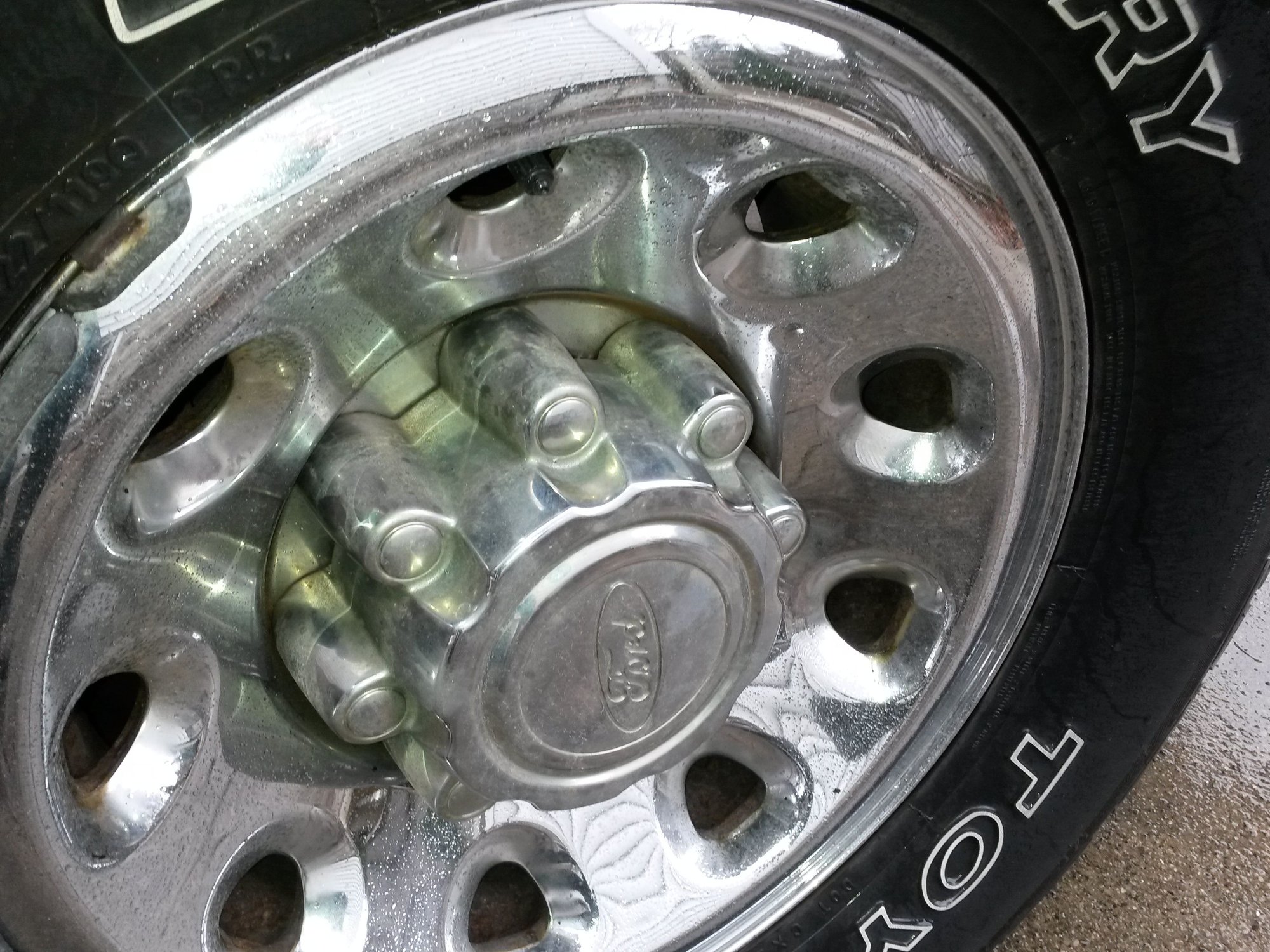

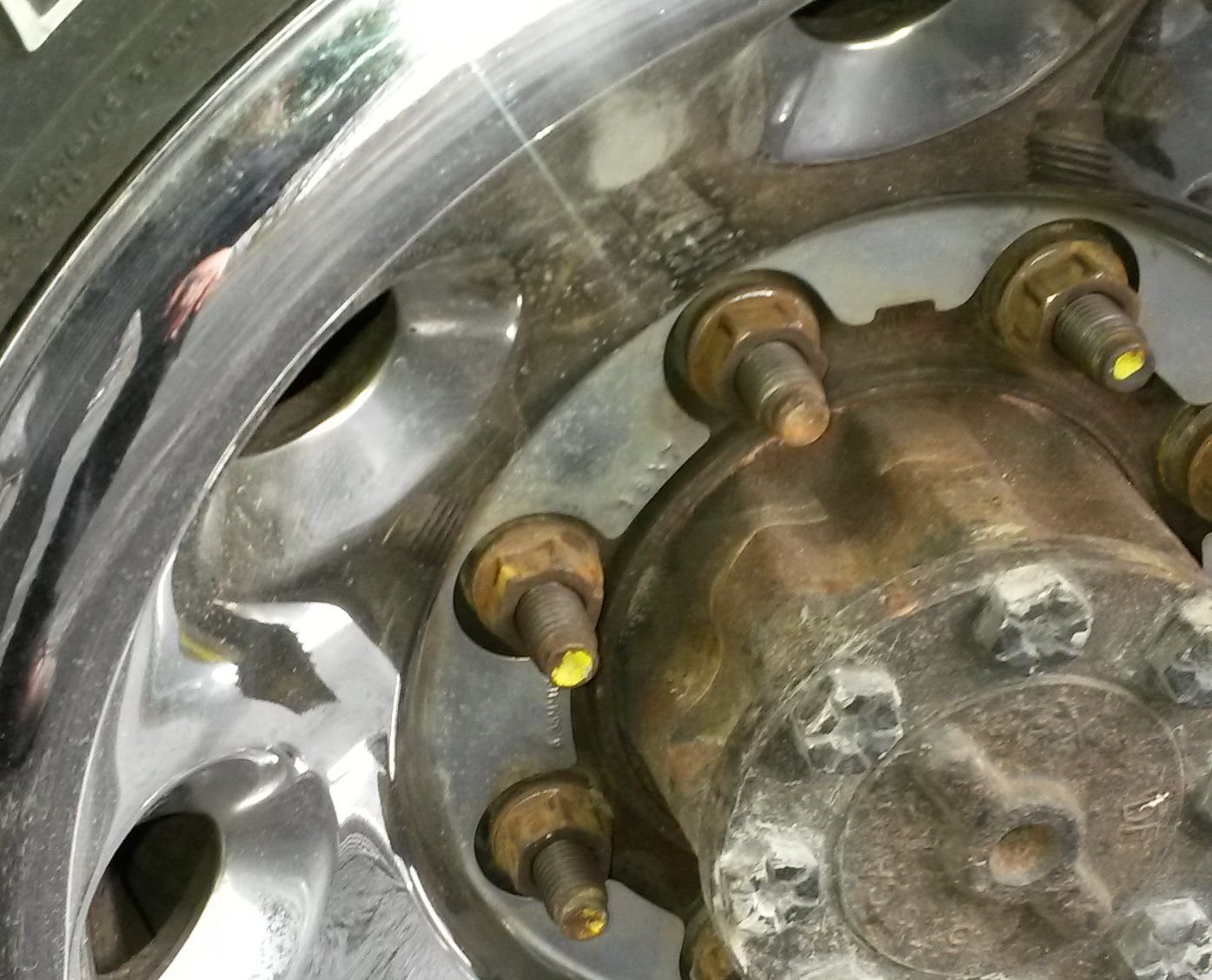

Please bear with me, I haven't attached photos before.
One shows the lugs with a lip around the lug close to the hub that the center clips to.
Also shows the hub cap material close to the lug preventing the cap retainer from reaching this lip.
The other shows the center installed but is unable to go on far enough to reach this lip. Holding the center can be pulled of easily. My fix was hoping to buy a spacer to bring out the lug by about 1/4 inch. The center only clips on to 4 lugs.
I'm sure I haven't explained this well but hope you see my question

That standard chromed plastic center cap should look like this inside (the one on the left, the right one is an '04 H-D cap).
These caps grab onto the lug nuts by the flats, not the inner lips if I recall correctly and they should grab all eight of the nuts not just four of them.
Sammie (Christina) runs those same chrome clad steel wheels with the standard chromed plastic center caps and apparently they stay put for her.

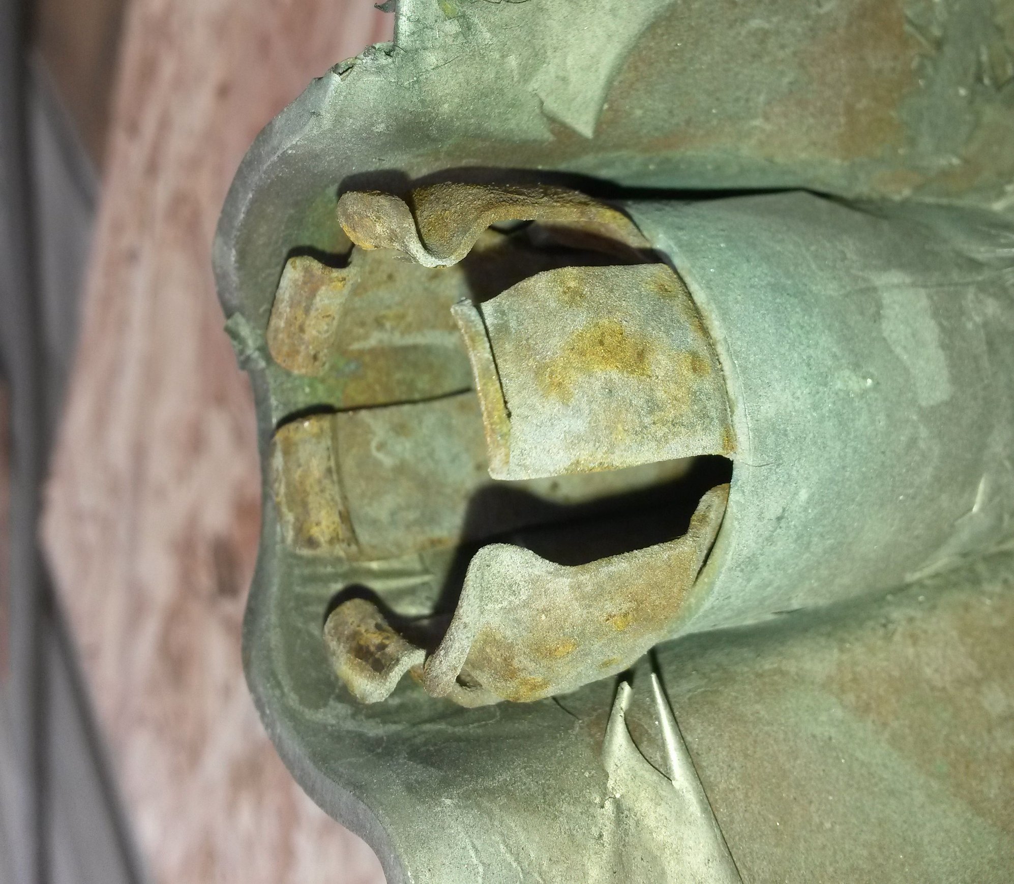

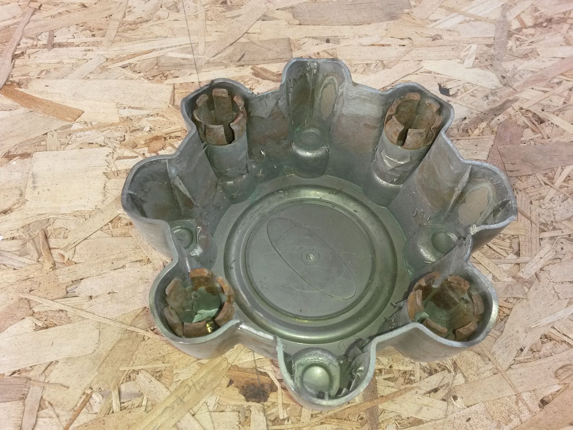

Old Mar 3, 2017 | 02:55 PM
Estam's Avatar
Estam
Joined: Jan 2009
Posts: 141
Thanks guys. This shows my problem well, the hubcap doesn't mount flush with the hub due to the chrome wheel cover, the grabs cant mount the lug's lip. Shows just four grabs.

Your center caps are aftermarket knock-offs with out the casting numbers.

With fake lug nuts also!
It has the same oval casting marks similar to W3EZS's.

Very interesting..........
I don't know if those are OEM or aftermarket center caps, but they are definitely different! Yours do lack the engineering/part numbers and other markings on the backside like the others show.
The only other time I have seen that type of metal clip style cap was in a writeup that Steve (sddesigns) did where he modded them to properly fit the shorter Warn locking hubs to eliminate the gap those shorter hubs give in the caps. I had contemplated modding a set for my other front axle with the Warns but I couldn't find a set of the metal clip caps, only the 8 clip plastic ones like I have. I though that maybe they were a very early design....

I'm the second owner and phoned the original owner and the wheels and hub caps are original. I'm presuming this is not a common occurrence and am going to have to find a way to space 4 of the lug nuts to accommodate the clip on the cap.

I'd like to see the matching original lug nuts to see how different they are.
