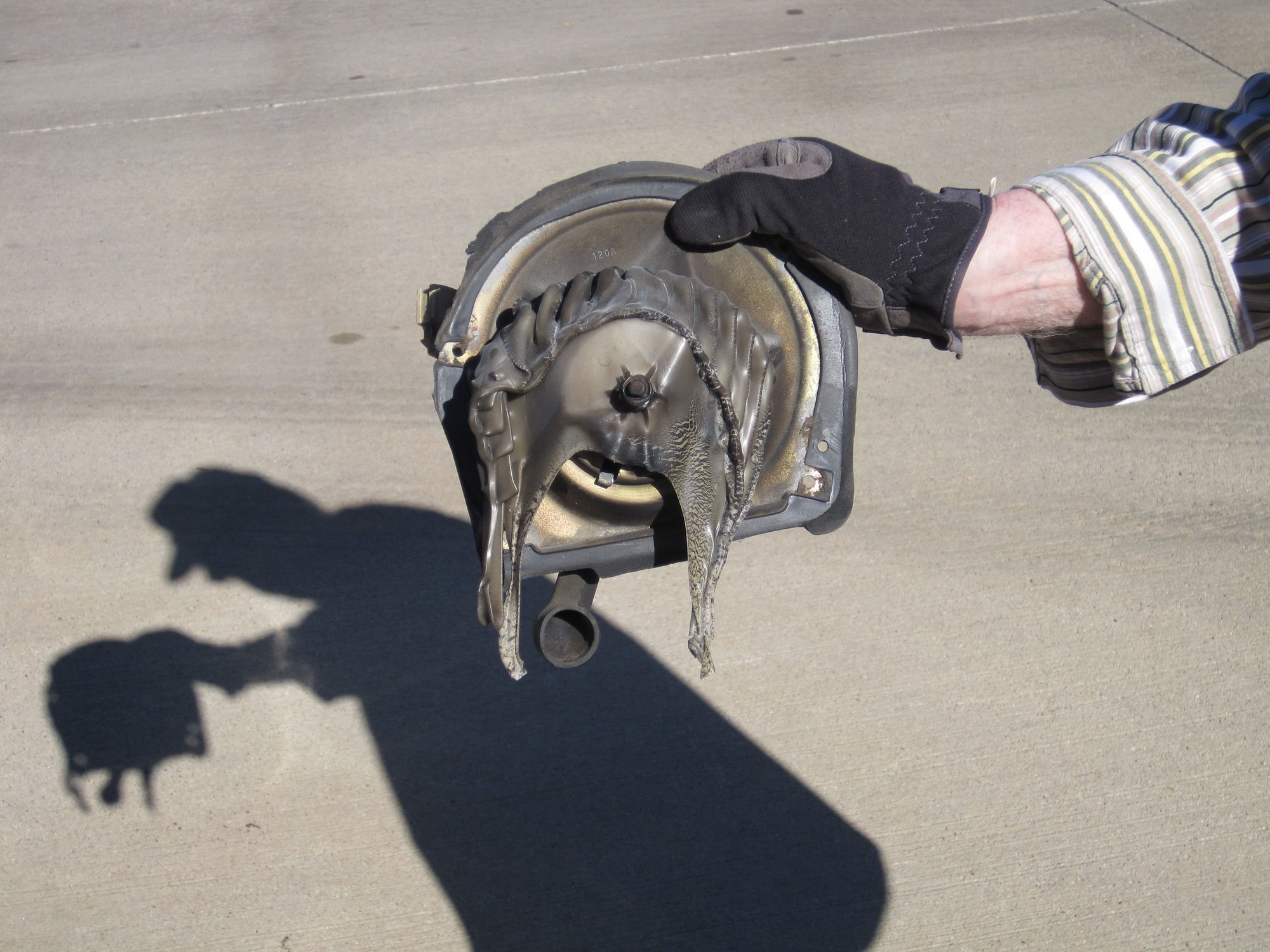

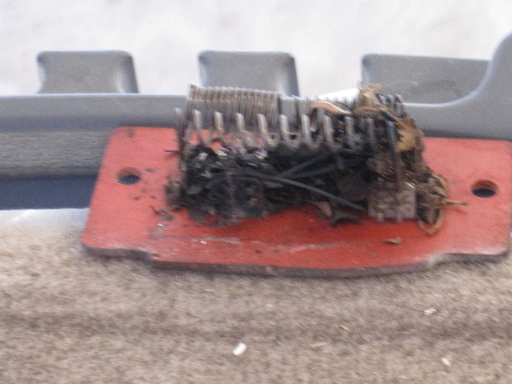

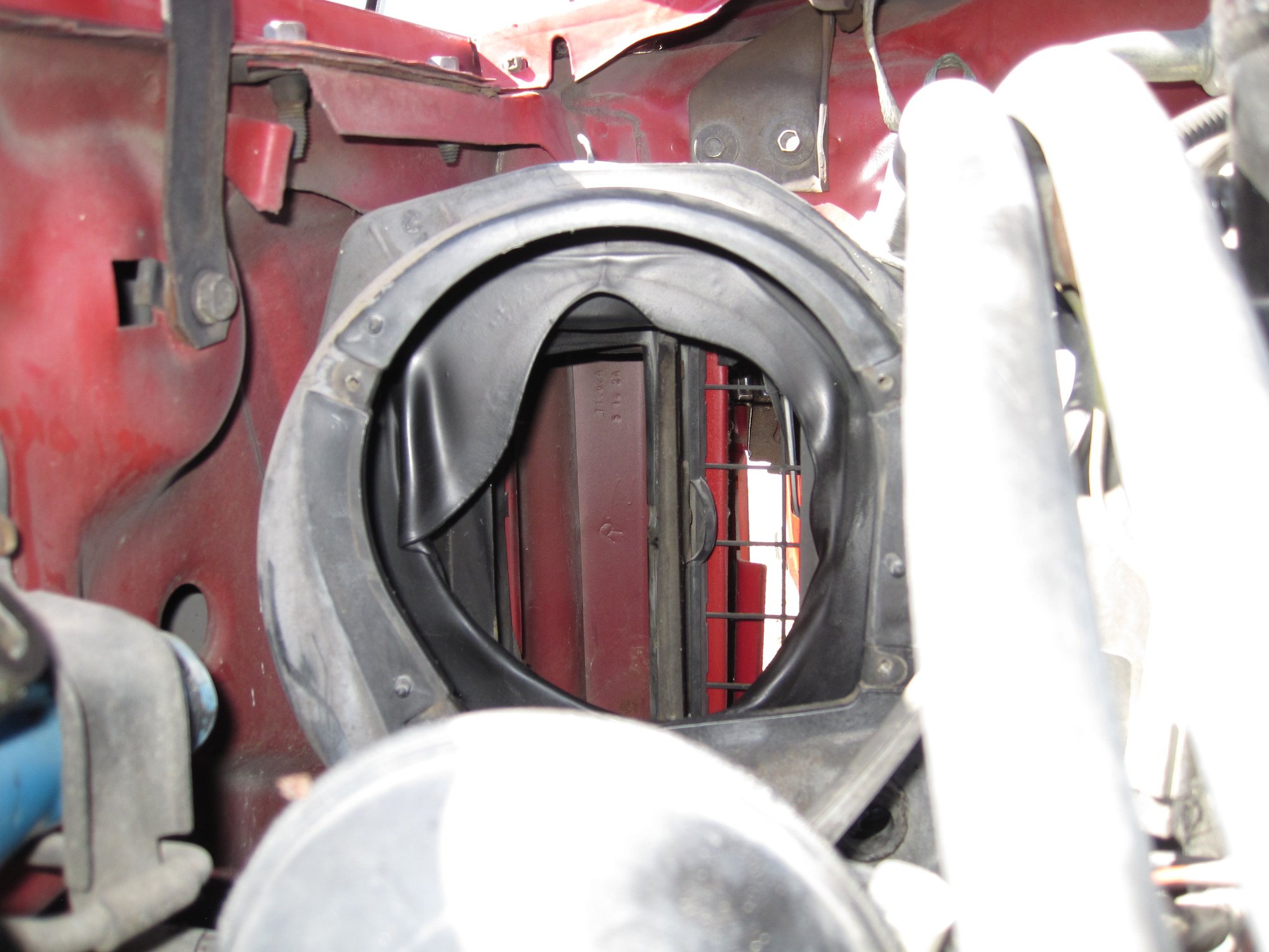

Had this little surprise yesterday. Started the truck and in a few seconds smoke started pouring out of the vents into the cockpit and out of the outside fresh air vents. After extinguishing, this is what I found this morning. If you have inherited or bought an old truck make sure you clean out the old leaves! Sorry for the lousy pics but I'm sure you get the point. Lucky the whole show didn't burn to the ground! Cheers!

Old Jan 31, 2017 | 10:53 AM
82_F100_300Six's Avatar
82_F100_300Six
Joined: Jun 2008
Posts: 2,875
Likes: 30
What is the part? Are the coils heating elements?
Old Jan 31, 2017 | 11:34 AM
GLR's Avatar
GLR
Joined: Sep 2003
Posts: 53,988
Likes: 2,395
From: NY and VA
Blower motor resistor.
Leaves and debris fall through the cowl vent, which is why some guys use the 87 -96 (97HD) cowl vent with smaller openings. The debris will also wash down the cowl to lodge behind the kick panels in the cab. I bought an 86 cab in NC that caught on fire and burned the dash.

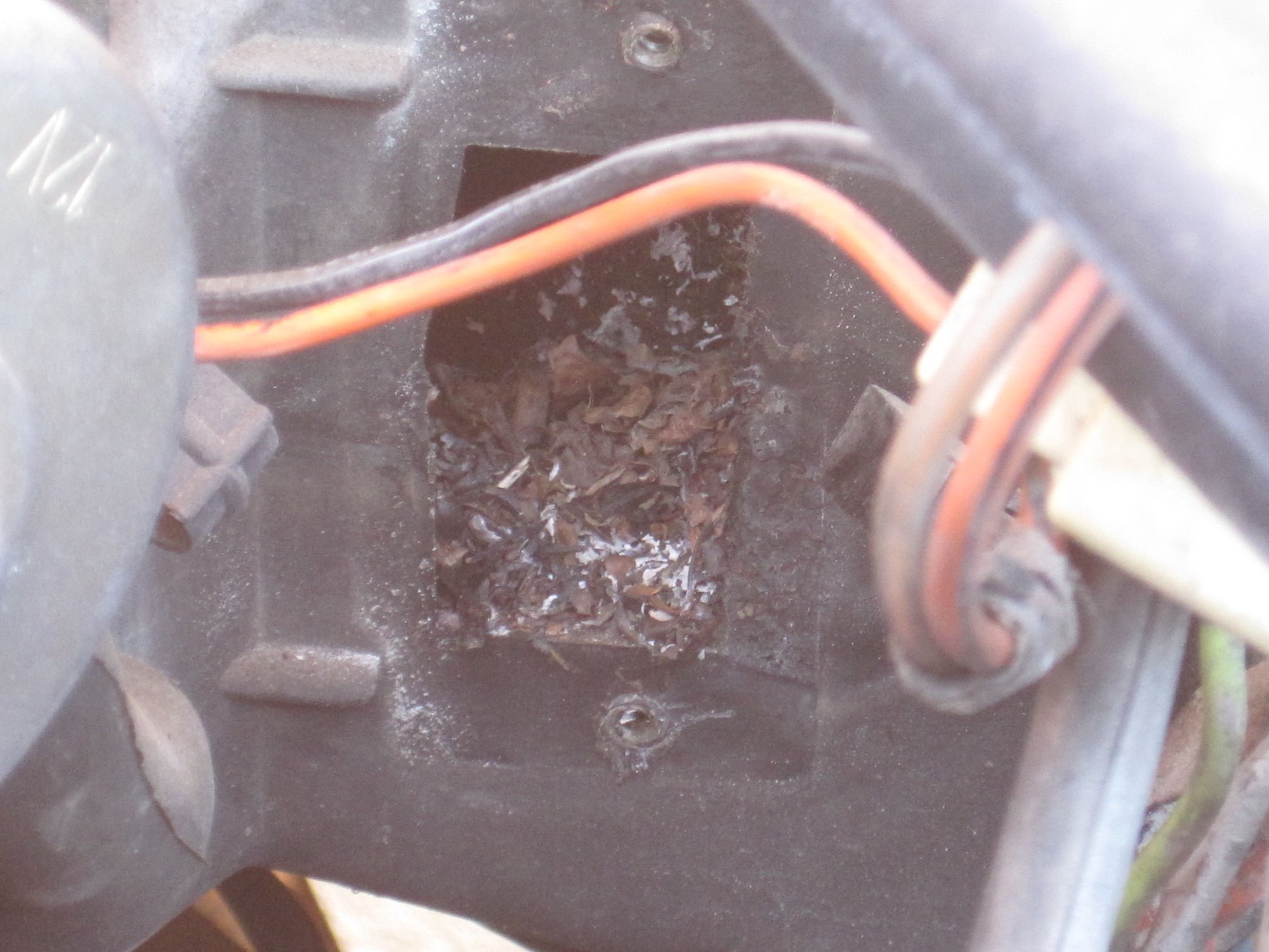

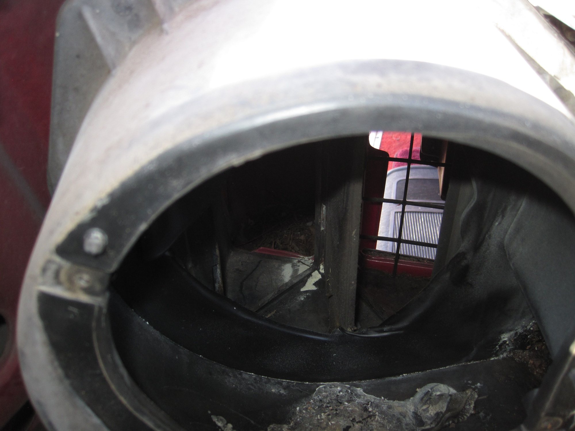

Old Jan 31, 2017 | 11:49 AM
augsburger's Avatar
augsburger
Joined: Oct 2016
Posts: 35
top left corner you can see the kick panel filled w/ debris, melted pool of squirrel cage in the bottom of housing
this squirrel cage fan is TOAST
melted rear housing
Thanks GLR. That's exactly what I found this morning. The kick panels were full of debris and had filled up the squirrel cage all the way to the resistors. Here are some more pics of the damage I found. I now obviously now am in need of a new blower motor housing. Here are some updated pics. Not pretty. Check your kick panels!

where sits that resistor?
and how to get behind the kickpanel without cuting the truck in slices?

It is mounted on the side of the A/C evaporator housing next to the blower motor housing. The housing encloses both the blower motor and the evaporator.

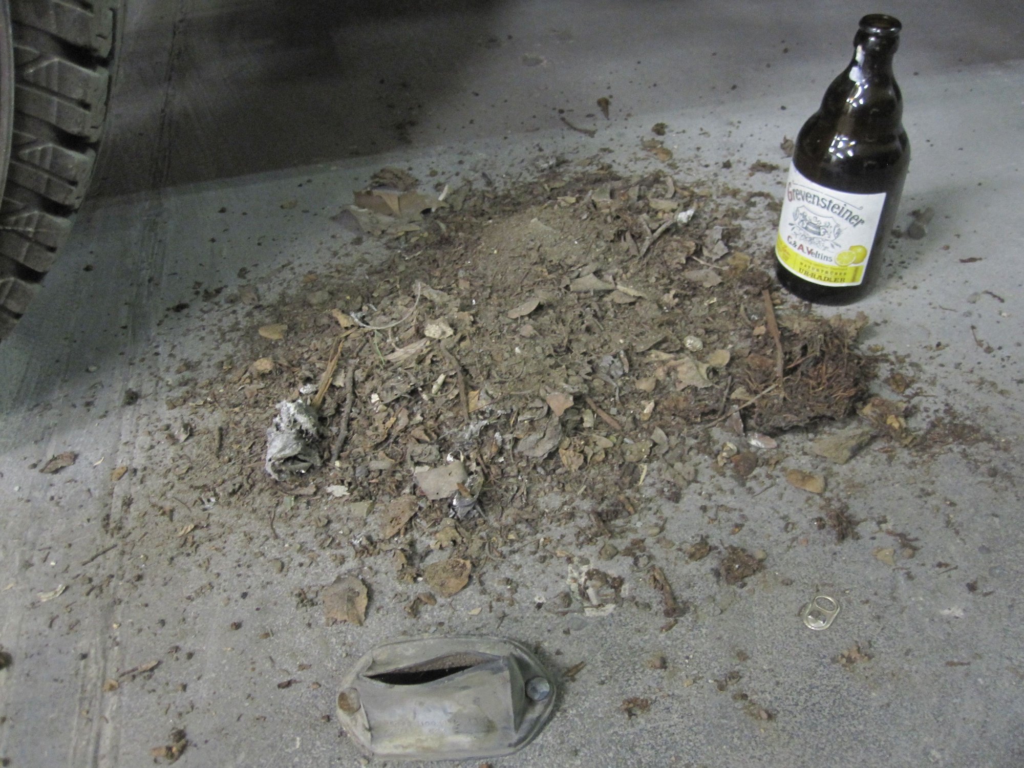

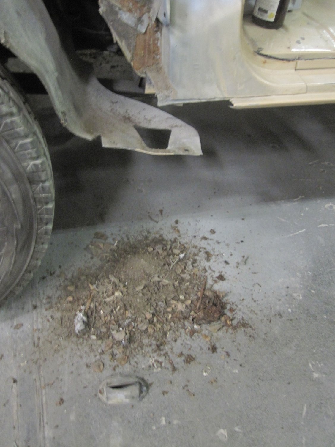

Old Feb 5, 2017 | 03:04 AM
hardward's Avatar
hardward
Joined: Aug 2016
Posts: 74
From: ruhrpott germany
surprise, surprise...
see, what I've found in the "sidepockeds" of the kickpanel.
fortunaly all the dirt is dry, so no rust is inside the "pockets".
again, thanks, hardy
Old Feb 5, 2017 | 03:36 AM
Cg willie Willie's Avatar
Cg willie Willie
Joined: Jan 2016
Posts: 117
those rubber boots tend to collect a lot of dirt and debris I removed mine some time ago
Old Feb 5, 2017 | 04:26 AM
hardward's Avatar
hardward
Joined: Aug 2016
Posts: 74
also thinking about that, they'r working like traps.
Old Feb 5, 2017 | 09:53 AM
FuzzFace2's Avatar
FuzzFace2
Posts: 30,912
Likes: 4,123
From: Angier, NC
Mine was dry dirt also and used shop air to blow the dirt out.
I did not remove the rubbers so will look into that when pull the fenders for painting.
Then again the truck will not be parked under trees so how much junk will get in there?
Also when washing I would run a lot of water down the cowl to flush out any dirt that may be in there.
