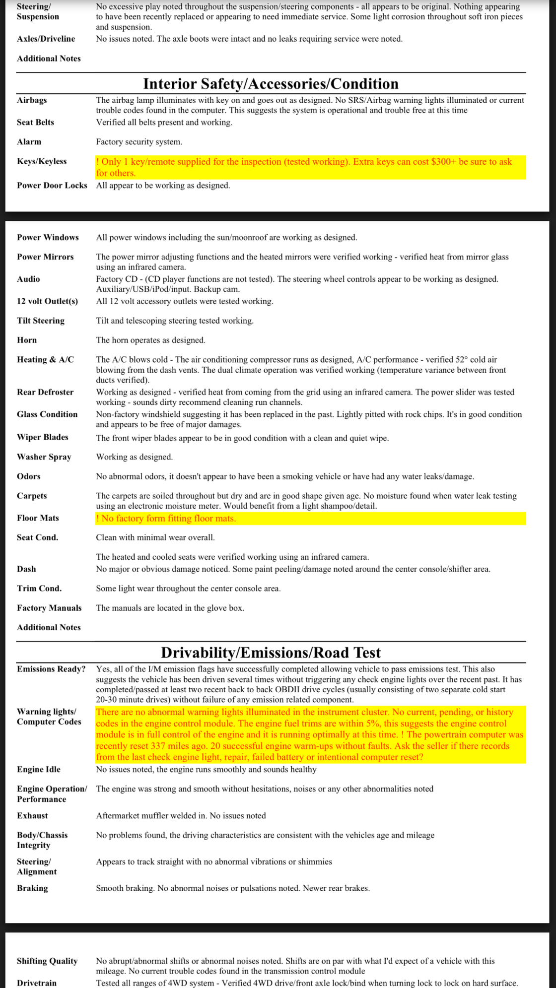

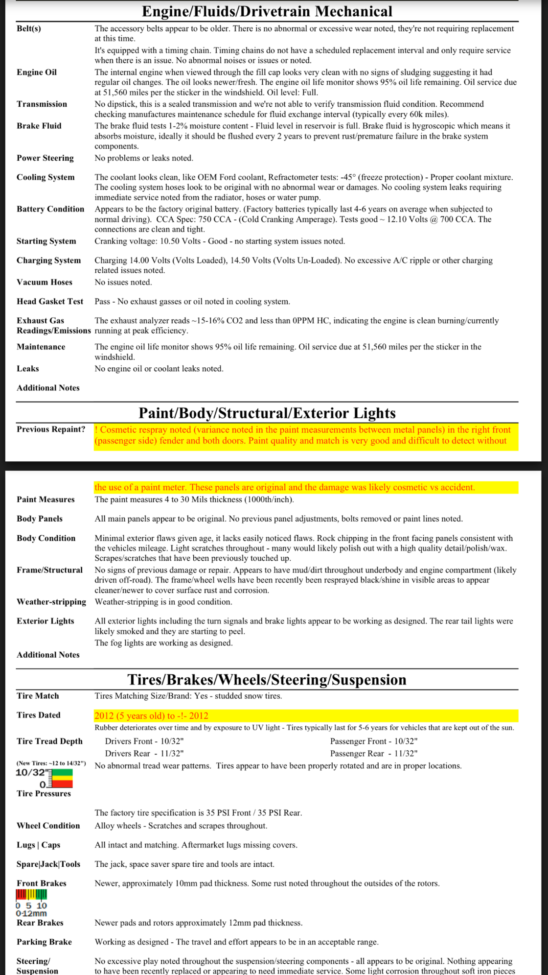

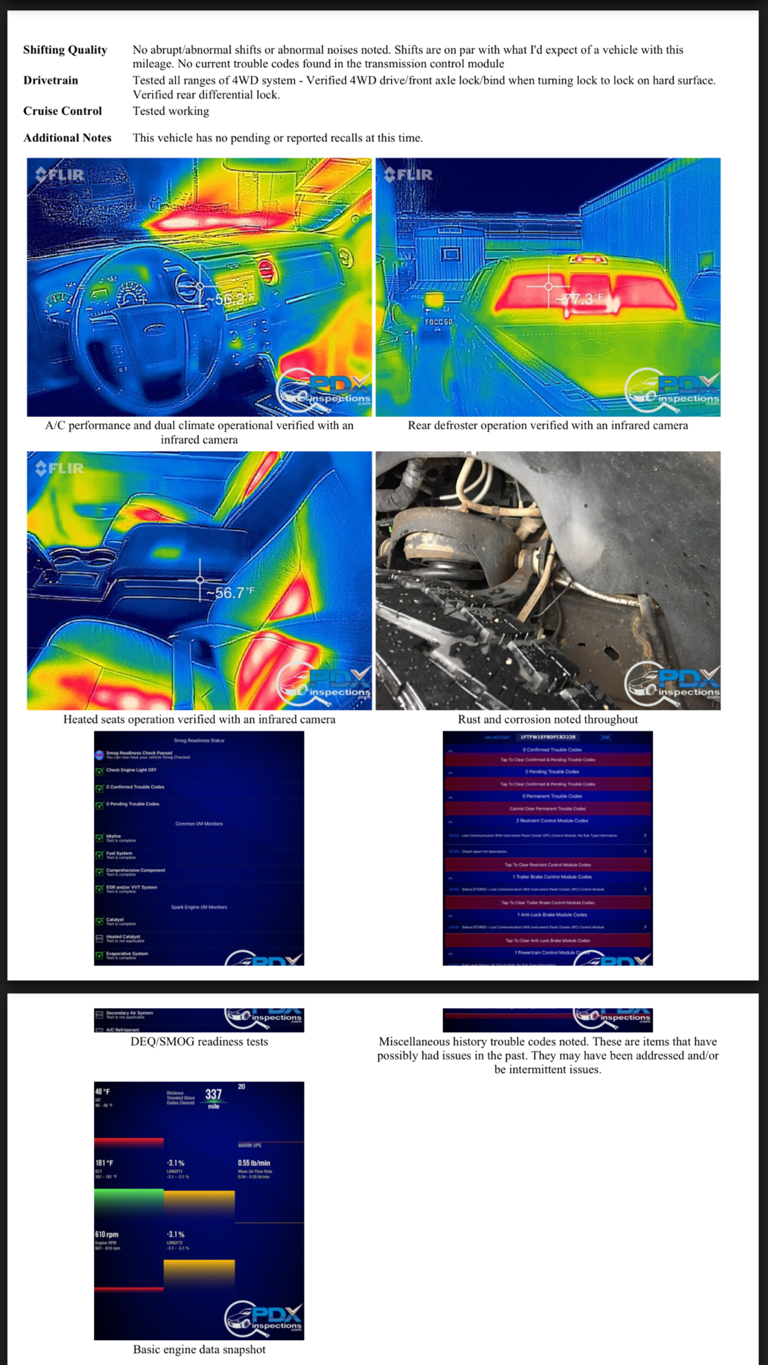

Haha. Just had the inspection done and I have attached it to see. Nothing major at all. Only question was the Drivetrain code that was cleared just over 300 miles ago. My only thought is that it got cleared possibly when they converted it for sale in the US? Any thoughts on that possibly?

Yes, that was the reason. I would demand the CORRECT dash as well.

WOW!
I've never seen an inspection like that before.
