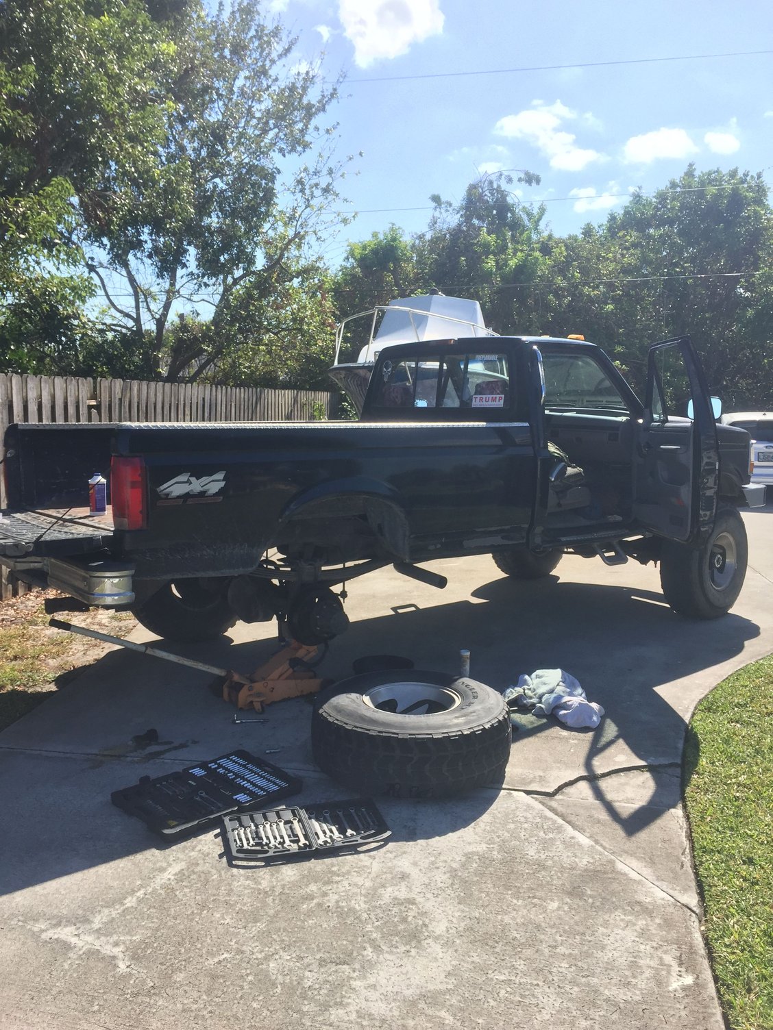

Slip yolk on the drive shaft needed some love.
New mirrors.
Me and the truck .
Girlfriend and her truck.
Throw out bearing went kaboom lol.
Wheel cylinder was lubricating the driveway.

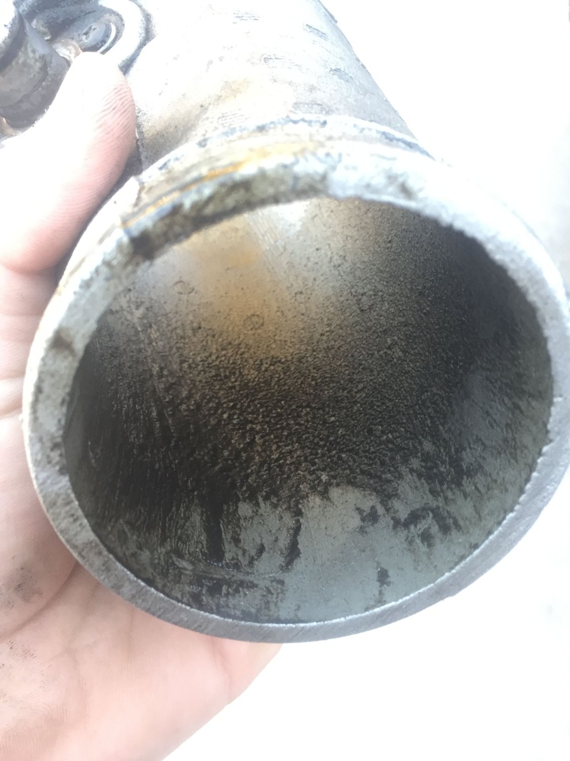

Also my truck smokes quite a bit at a cold start. And smells like oil, I found the vent tube that goes into the intake pipe is where it is coming from. Is this normal to have this much oil coming out of that vent tube? The vent tube I'm referring tube is the short little 90 hose that comes out of the valve cover
There was a tiny puddle of oil on the lip of the turbo too...

It's normal for these to consume a certain amount of oil through the breather system, it's sort of a scrubby design.
Pull the oil fill cap while it's running and see how much blowby there is. Steady steam is normal, huge amounts of steam carrying oil mist is not (put your hand over and have someone Rev engine).

ive Checked it for blowby and it's not bad at all. I can barely feel it with my hand over it. But does that look normal? It just seems like there shouldn't be that much oil coming out of that vent tube. What is the purpose of that vent tube?
