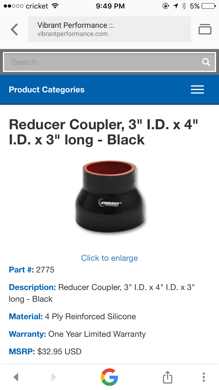

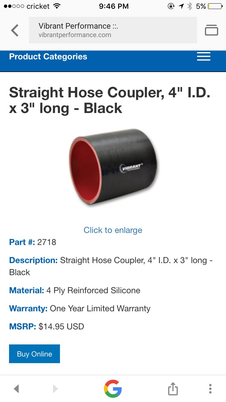

Here is what I ordered.
The place I ordered from had better prices and had a discount on the order.

so here's what I'm gonna be using. $110 and I think it was well worth it. Now all that is left to do is cut it and weld the pieces together. I'm excited!
