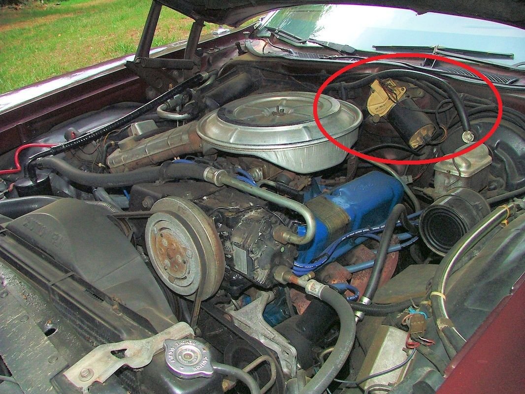

I was curious if the power braking system has any influence on the vacuum system in these trucks?
I have been dealing with a problem in our truck(1978 F100 302 2bbl C6) for a while now where it comes out of gear at lower rpm's.
Yesterday i did a lot of work on it...changed out vacuum modulator to the green stripe version with the screw backed out a couple turns and lowered the idle speed(which was way high) as well as lubing the throttle linkage so it came all the way back to idle...these things helped touch but was still having the issue when would come to complete stop...while running down the road it operates perfectly.
So I experimented on my street and just put it in gear and let it roll at idle speed...it never kicked out of gear Until I applied the brakes to a full stop...release the brake and 5-7 seconds later it would go back into gear and start rolling again.
thoughts?

The other reason i am asking about the braking is one of the vacuum lines runs up the firewall and appears as thought it somehow ties into the brake booster.

Does the engine rev like the transmission is in neutral, when it's doing this?
Yes....but while going down the road the transmission does not slip nor comes out of gear until you come to a stop again. or after a good brake application.
Absolutely. There is a vacuum line off a tree at the back of the intake that connects to the brake booster.

Have you checked the vacuum line to the modulator?
Yeah..I replaced that line
as far as the brake line vacuum part...what would I need to fix if that is causing my issue? Something inside the booster itself?

If the vacuum line and the booster connector are good (not leaking) then you are likely in for a booster replacement.
