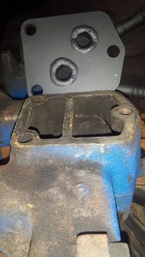

Then it was on to the intake and plug the EGR port that feeds the EGR valve. This is because I am going to use a hot water heating plate on the bottom and coolant will be up to that point and did not want any to get thru to the intake track.
Heating plate with hand made gasket on the left.
Intake with plug, sealer was used before I installed it.
Now before I made the gasket for the heating plate a test fit on the intake showed an issue can you see what it is?
Yep the welds hit the divider so I took a grinder to the divider till the plate would sit flat. Sorry no picture of the grinding done, I was in a zone!

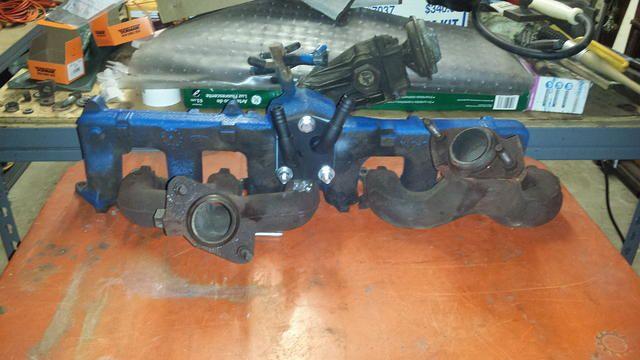

Well the manifolds are back on the motor. all I got to say is you have to have 4+ hands to mount them back on the motor.
Once you have the right ports lined up with the right ports on the head and had 4+ hands all went as planed.
With the Y pipe bolted in place I only need a 6" long piece ofpipe to hook to the stock exh system.
One thing I do see being an issue and have not heard anything of is the long ALT bolt. As you can see in the picture it comes in form the rear and can not be removed!
I hope I can mount the ALT in the bracket and then get it bolted to the block. I will deal with this later as I plan on going with a 3G because the ALT I have does not match the harness I am going to use so thought best to go with 3G ALT.
Another picture of the manifold setup showing the heating setup.
Dave ----
