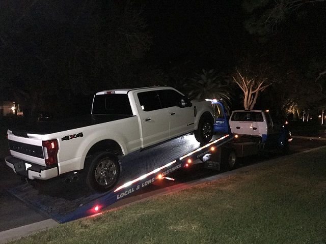

I wouldn't consider a diesel unless for heavy hauling. This stress only comes with diesel:
