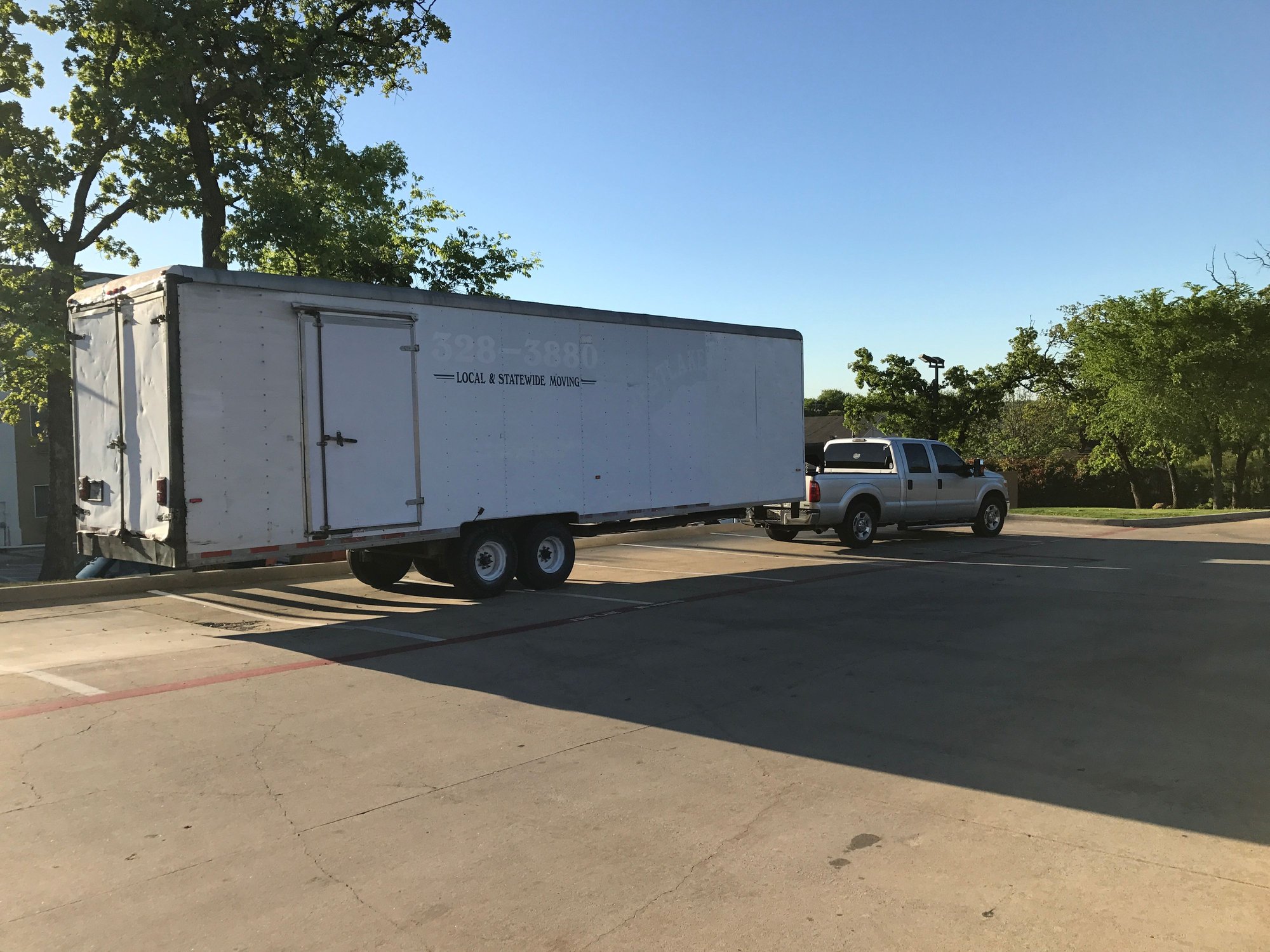

Update
Just an update drive down from CO on friday and picked up a good deal on a 32 foot cargo trailer. Towed back and got lessons real quick in construction, heavy wind gusts, rain, and quite a bit of snow. All in all truck pulled like a dream. Now air bags in about a month and I will be set. Also didnt squat the truck that much at all. I am a lil worried with all our stuff I may be a few hundered punds over max tow.

Geez that thing sits high. I would highly recommend some sway control, and whatever you do, don't load the back of it heavy.

It may not be the prettiest but man that looks like a BEAST of a trailer.

Thanks towing from TX to CO pulled great I never wanna tow a bumper pull again lol
It does sit high, but looks like a gooseneck to me.
