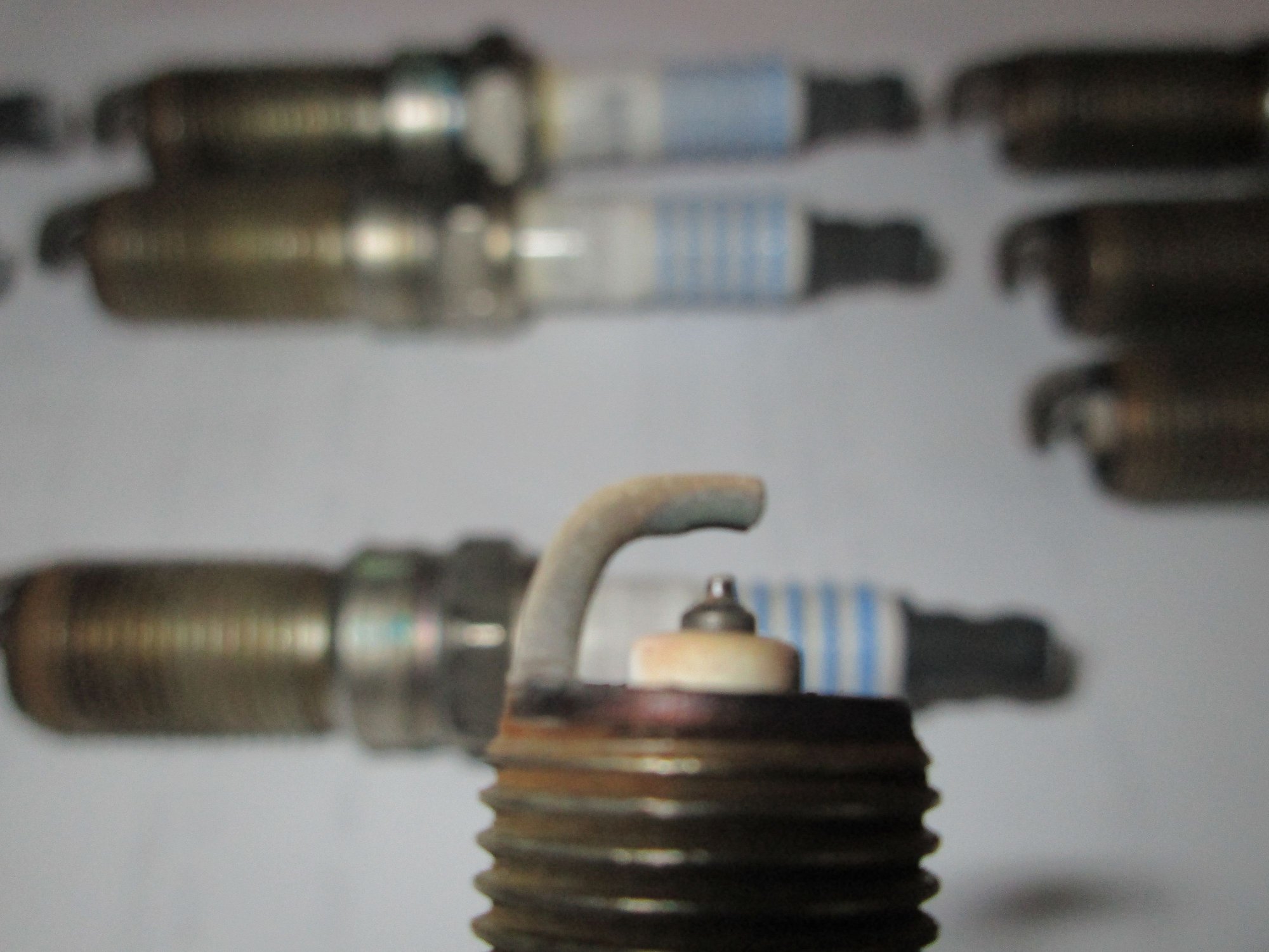

How did they look? When I had the 100 k tuneup on my old 2000 V10, the plugs looked like they had a lot of life left.

They basically looked like this one a little bit of wear but couldn't feel any lose of power in the truck.

Best to change coz when they wear it puts more stress on coils then they go bad
