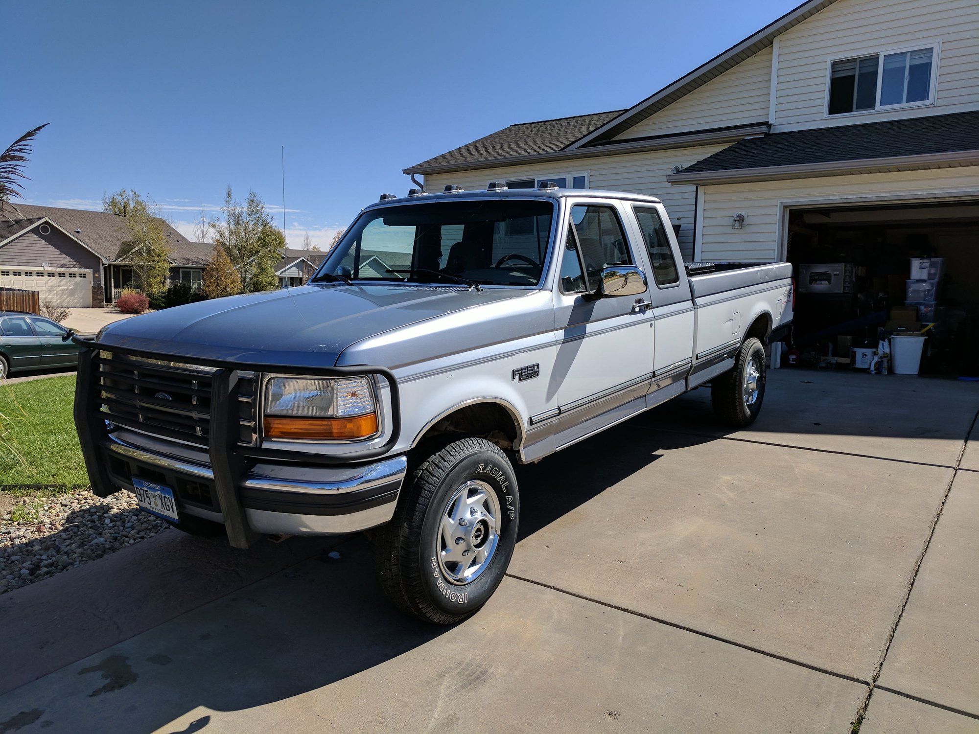

I assume you have an OBS F-350, in which case, should fit any Ford truck or Bronco from 92-96 (97 for F-250/350). I see them for sale in CO for anywhere between $250 and $500 if it's cherry. Like I said, they are hard to find in good condition anymore, so somebody whose been looking for one might be willing to spend more. I paid $35 for mine at the scrap yard. It was missing the a few little things and one of the cross bars was gone. I welded on a new cross bar, replaced the mounting brackets and rhino-lined it. Looks good I think.

Lookin' good. Wish I could find one for my 1990.

That does look good! Mine is off 2004 F350, decent condition I think

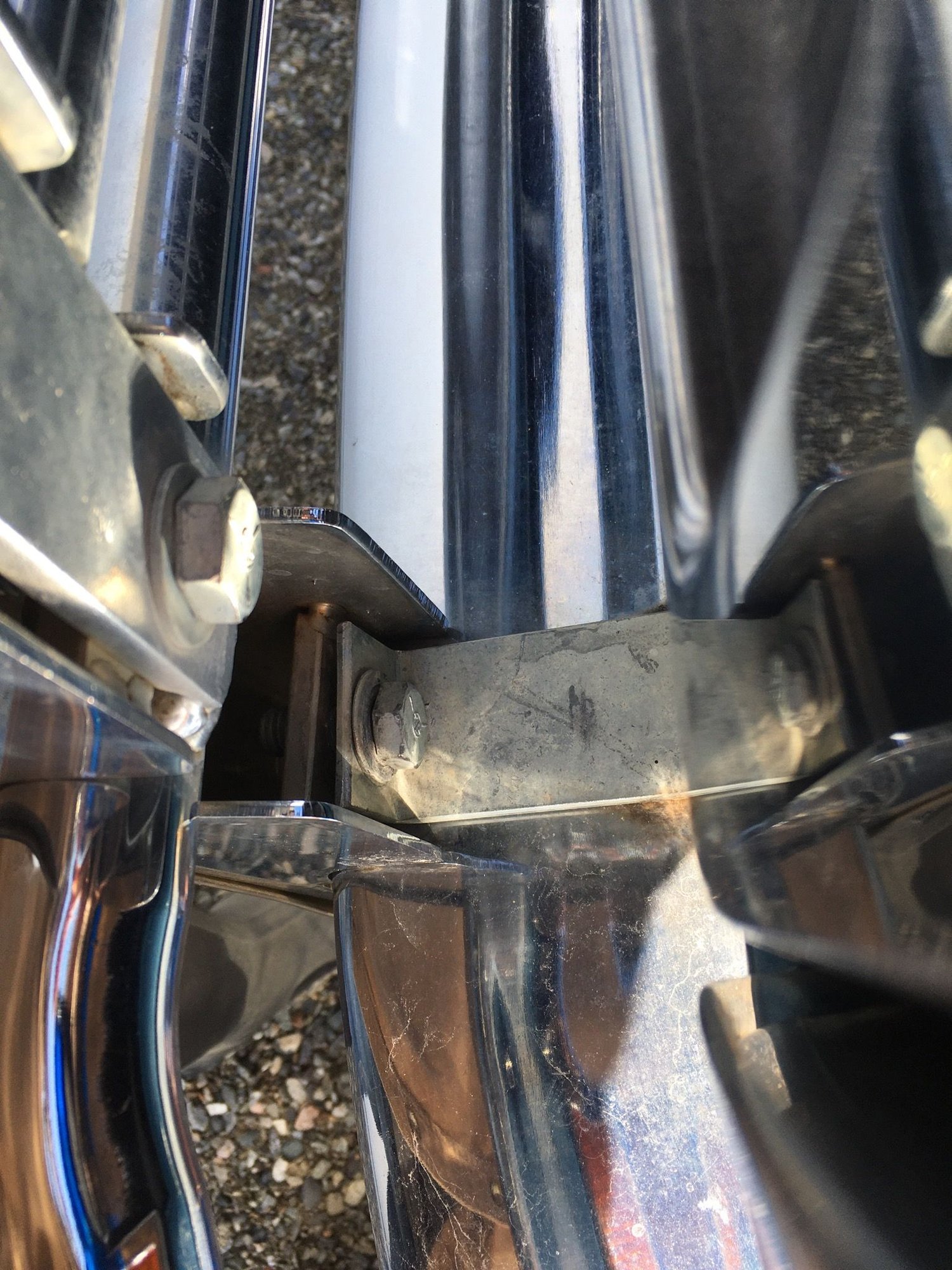

the top bracket wraps around the bumper under the grill and just hooks to the back of the bumper, bent stright up at the grille guard to bolt to the threaded tab welded on the grille guard, i think the bottom brackets could be made into a 2 piece bracket rather than the 3 piece
