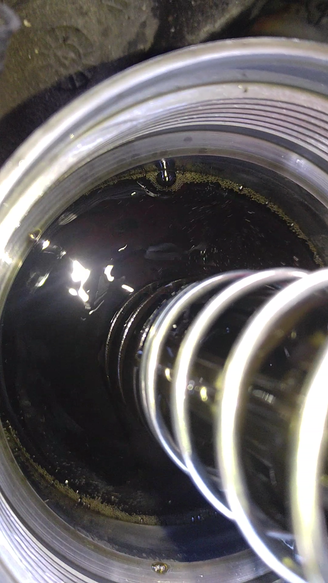

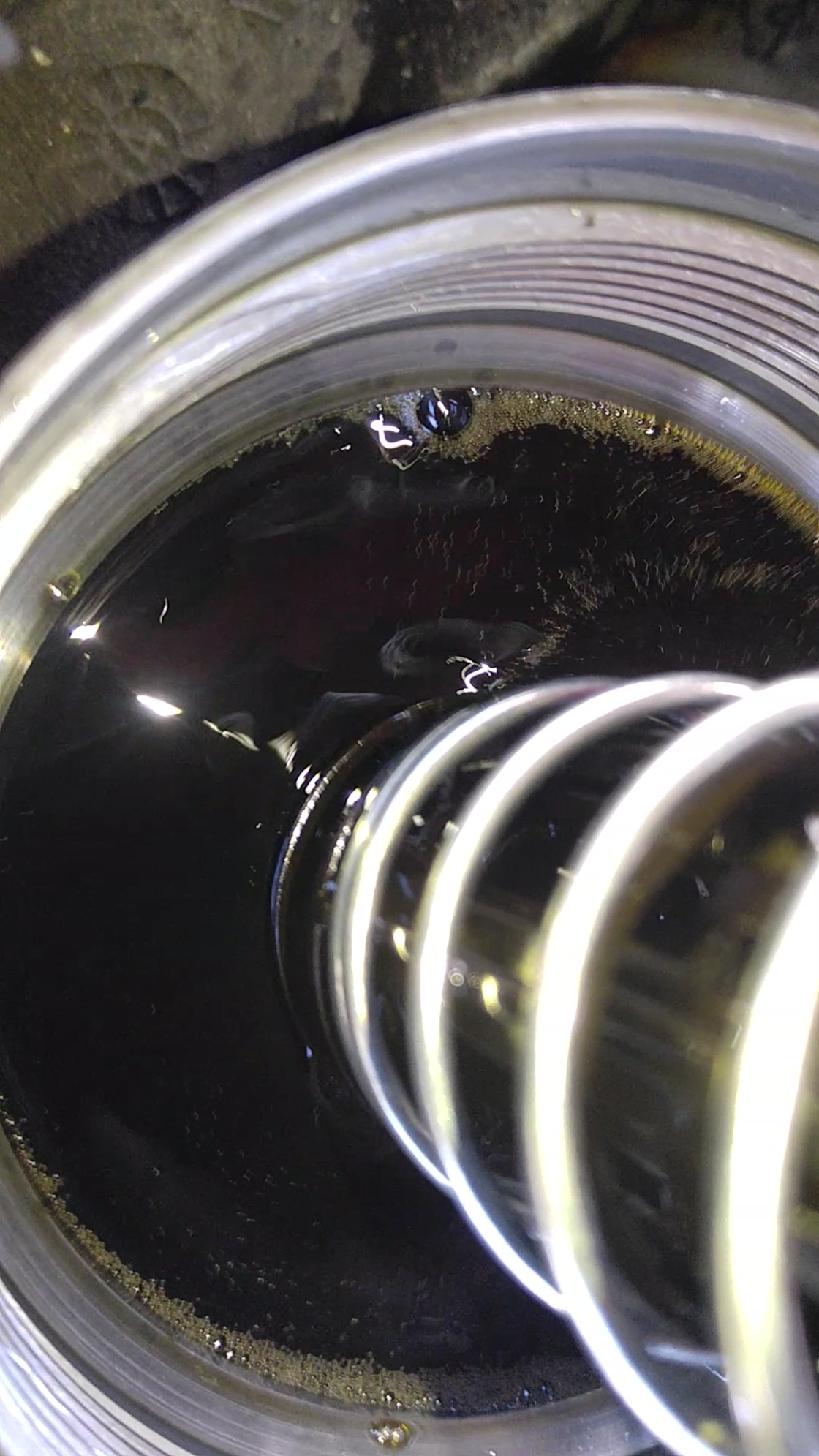

Also when i take the oil filter out and hold the drain down it takes 7 seconds to fill the oil housing to the top. Are these small bubbles a concern

The oil filter bowl feeds the pump and you filled it with air, it's normal.
I wouldn't worry about that yet, let's find the leak.
