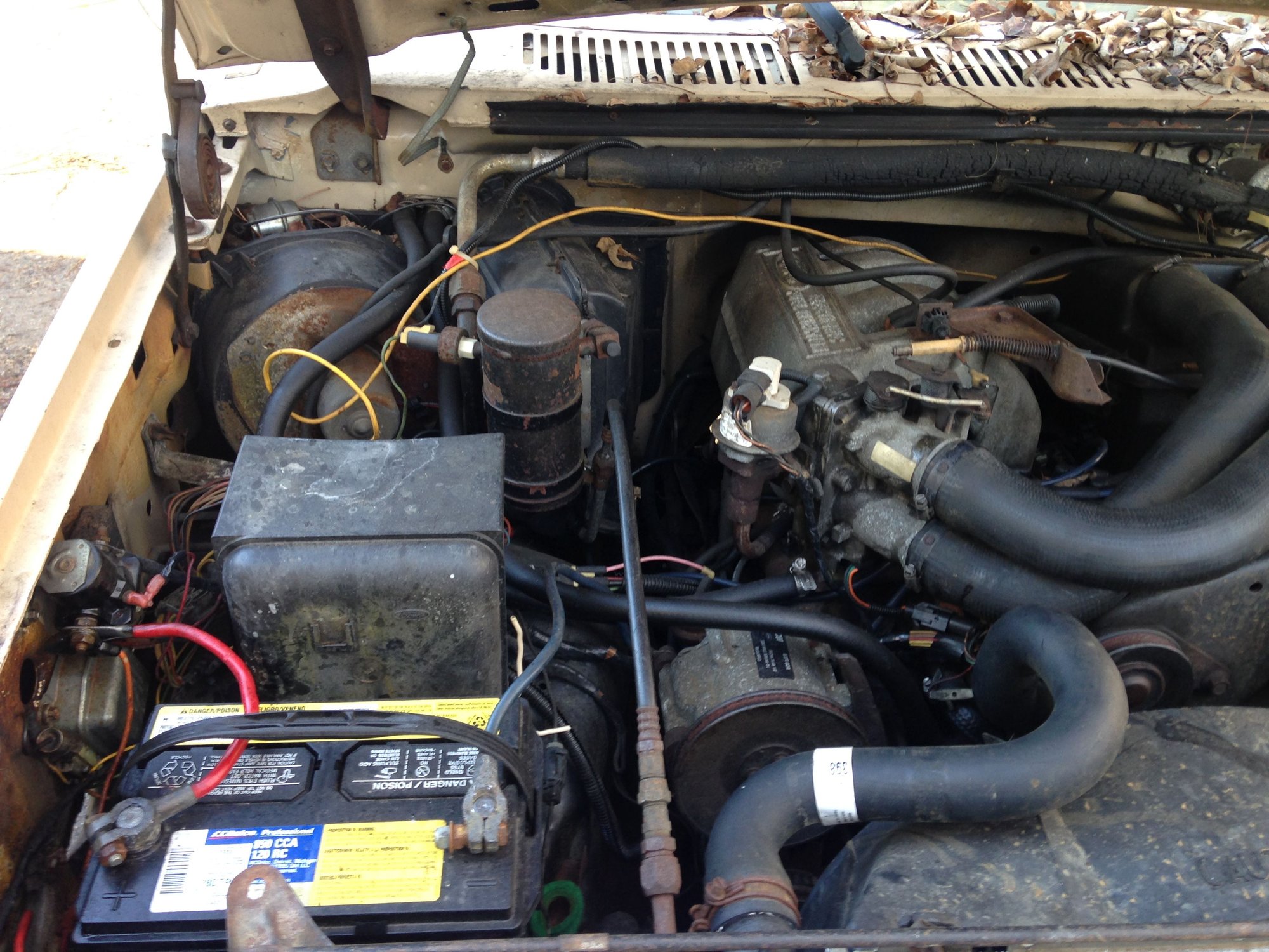

So I found these two cables coming from the EFI. I think this is why it isn't starting. Does anyone know what these two do one is a this red wire and the other is a thicker black wire. Thanks for any help

Those are probably for the second (disconnected) battery.
Interesting. I don't think I've ever seen a 5.0 with dual battery trays. (that's usually a diesel thing)
​​​​​​​That thing under the starter relay is the voltage regulator for the alternator.
Have you tried asking the computer what is wrong by pulling the codes?
