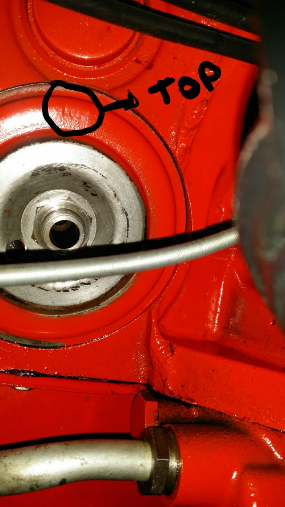

Greetings. I have an oil leak in the oil filter adapter. Seeing some images of several adapters I see that they are all mounted upside down than mine, my adapter is upside down that of the image and the top mark is next to the opposite. What is the proper position? My 292 engine

Thanks for the answer, my plate is like the one in the photo, but the holes are down and the top mark up

just turn it around so holes point up no big deal.if you have a leak its the gaskit behind the adapter

Thanks for the answers. Forgive my bad English. I already have a plate installed but seeing images I see that mine is installed contrary to the others and I wonder if it is okay like this

Yours is installed upside down. The holes go up to prevent oil drain back.

I thought so. But I entered the doubt to see the top brand in this photo

New ones, which are made in China, have "TOP" on the wrong wide. The holes go up. Yours is upside down.

Thank you very much for the clarification. I'll turn it around. I was so mounted when I bought it. Can influence the operation?

It keeps the filter from draining when the engine is shut off, which reduces the amount of time it takes for pressure to come up when it is started. That is a good feature.
