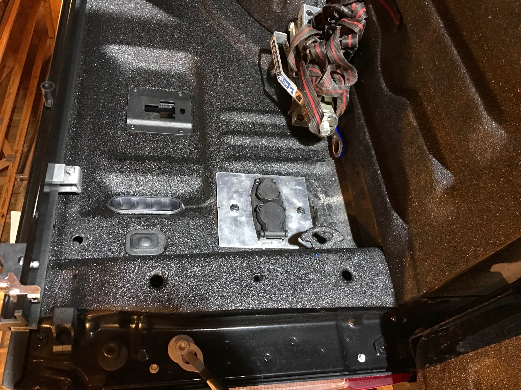

Spent the weekend installing the Camera on my 2017 Bighorn Fifth Wheel. First thing is the camera system is not made for a fifth wheel. I had to modify the truck wiring harness that connects to the truck female connector.
You can't have the umbilical cord hanging outside the truck box. I spliced 3' of 22 gauge wire to 7 wires under the truck to get the harness to connect to the custom plate I made for the in box connection of the camera and 7 Pin trailer connector.

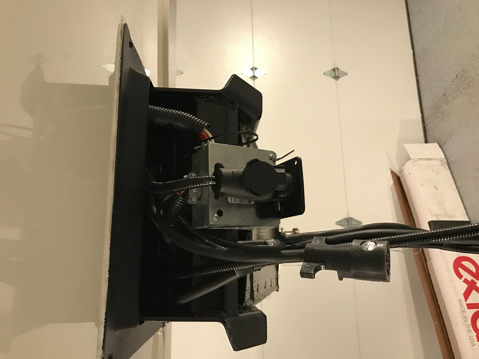

A wireless camera would have been nice as running the 50' trailer harness through the rear cap, under the trailer, into the basement, and fished through the overhang to the trailer pin was a pain in the A$$.
Its done, it works. Now to remove all the tires and take them to my Service Station to install the pressure sensors.
Sorry about the sideways pictures.
