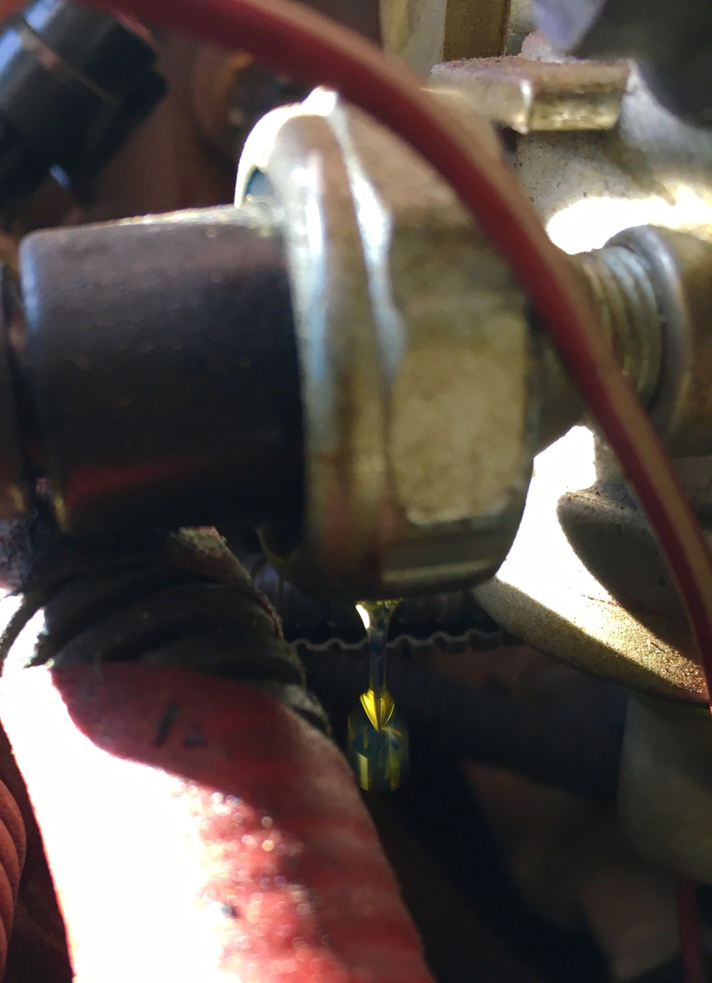

Leaking fuel pressure sensor...any tips?
Looks like my fuel sensor is leaking. Any tips to replacing it? I suspect using minimal torque is recommended. But teflon tape or other recommended thread sealer?

1/8" pipe plug.

it is a fuel filter restriction indicator sensor. plug it, if not the pink fuel rated Teflon and a new $100.00 sensor so if you never change your filter it will let you know it is getting clogged

oh and nice pic of the drip!

If you decide to get a new one or plug it make sure you don't overtightened I, you will brake the housing rendering useless

Nice pic. Put a pipe plug in it and call it a day

The 'drip' was almost a full stream and easy to pic. Though this sensor was easy to see, its drip was not as easy. Looking from the front, and even hovering over everything on my homemade over-creeper, this gusher remained obscured. It wasn't until I got my head closer to the firewall and was looking back (technically looking forwards towards the front of the truck) that I saw this thing dripping.
Thanks all for identifying this and giving some practical solutions!

When I bought my truck mine leaked as well, I had extra sensor hanging around, and that one leaked too. Toss it! Since the sensor doesnt really do much (filter restriction sensor) you can just plug it and remember to change your fuel filter every 10-15k miles.

At the risk of piling on, +1 above. NPT plug with a little Gasoila or other pipe thread sealer in a tube. Teflon tape makes it too easy to overtorque, which, for the reason stated above, you DON'T want to risk.

Not quite. It's only $33.71 at Diesel O-Rings. Of course, that's about $30 more than a pipe plug.

I opted for the pipe plug. Interestingly, the fuel bowl cover started to leak a little, and the 'clogged fuel filter' sensor started to leak before the warning light glowed...
