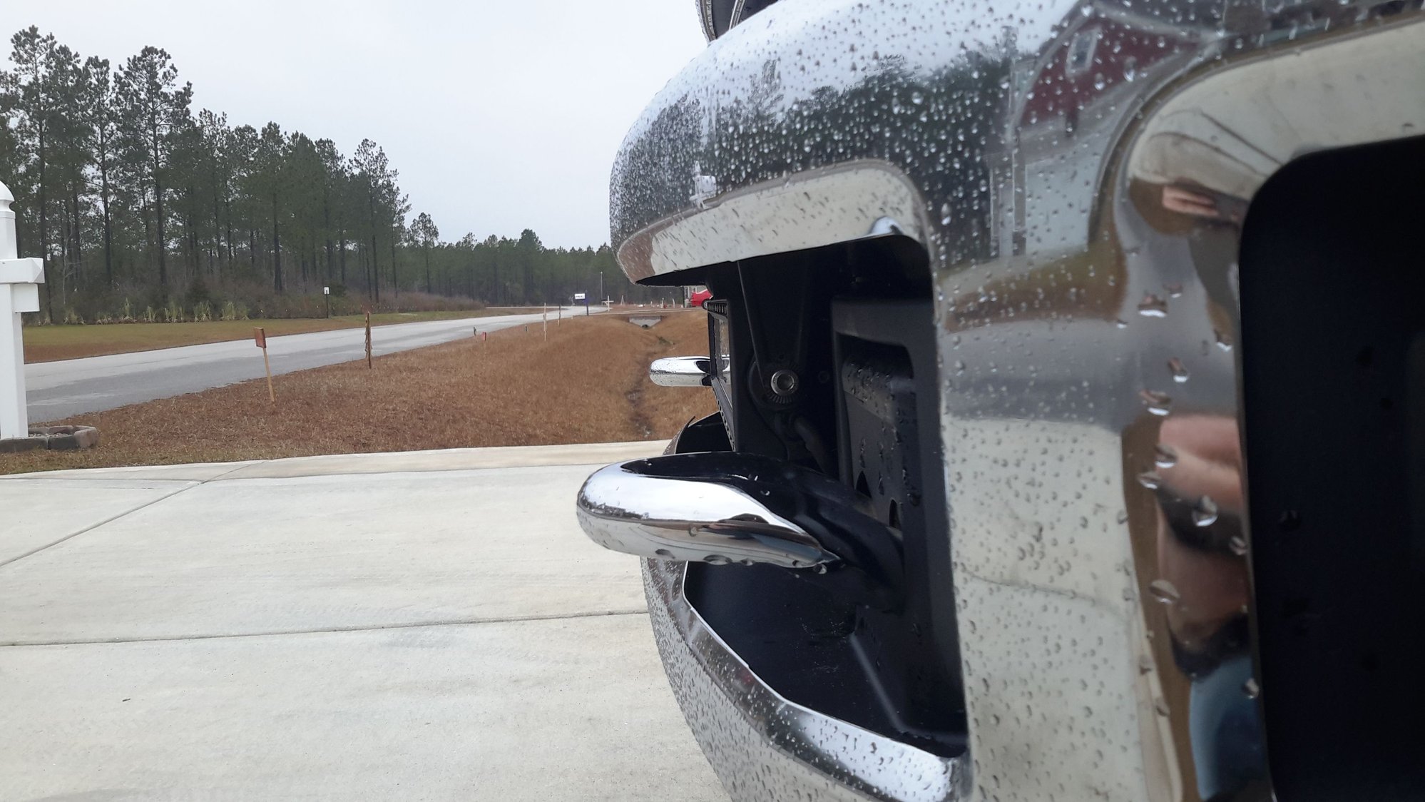

Here's my 20" mounted. Tucks away real nicely

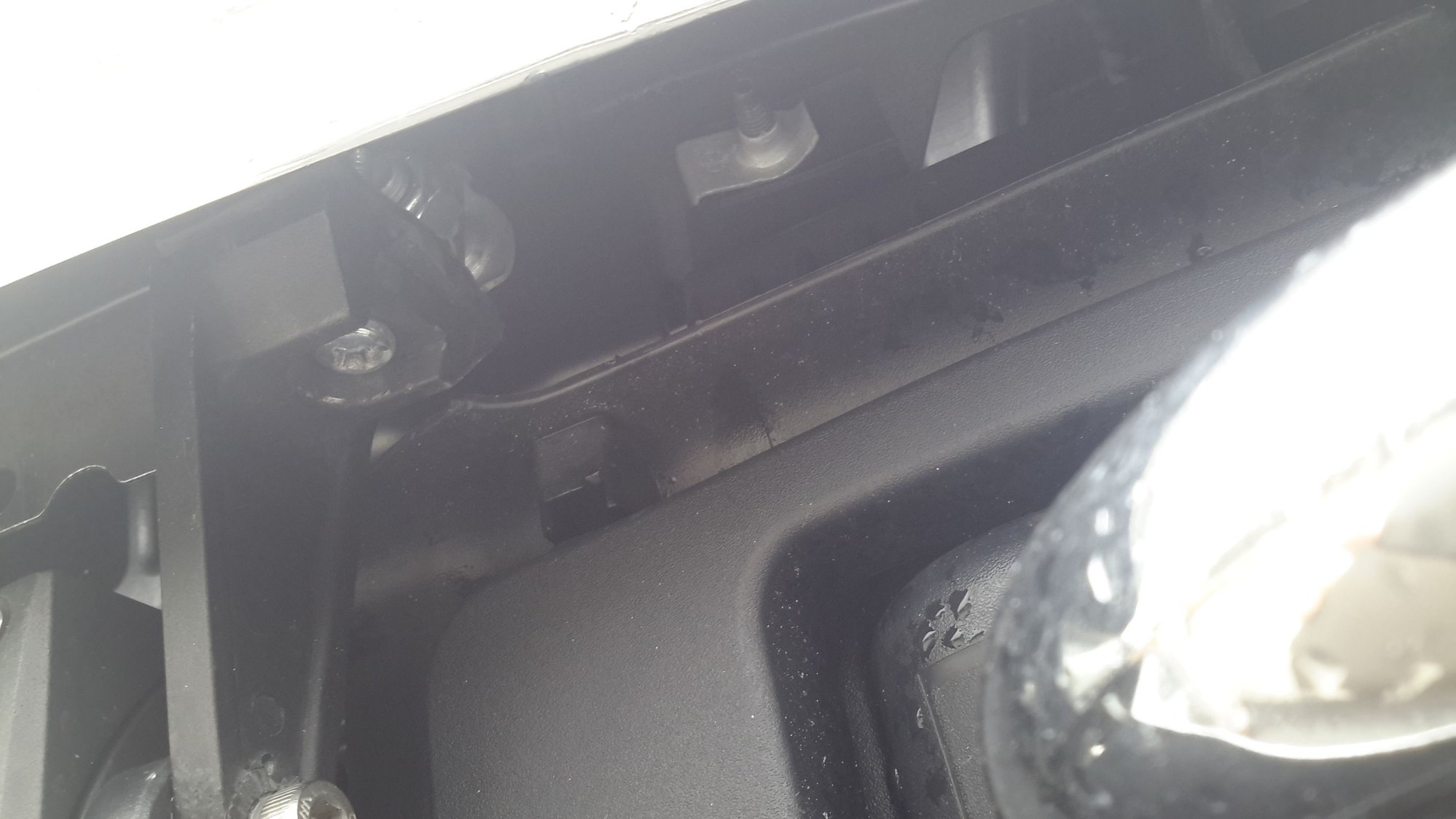

It's totron 20" double row light bar. I got it from Matt at Light it up Offroad. Had to basically cut and rip out front plate holder first. Made to little "L" brackets and mounted them to preexisting bolts under there. Kinda hard to see, but if you make 1"x1" brackets and have the light bar resting in there, you'll get the general idea how I did it
Looks like it belongs there! Just checked their website and it appears as though the light bar is sold out. No worries.. I am sure I can find one by the time I order my truck. Thanks for the info.
