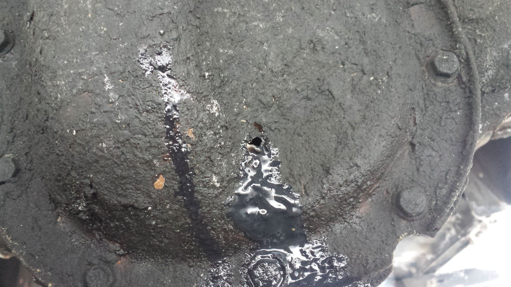

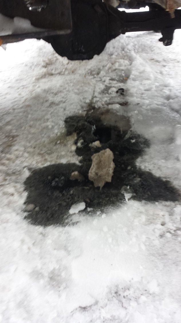

I found the problem before I even got to the truck. Drummmmmm roll please....
As I was walking up I seen the puddle of gear oil. You know it's oil when it hasn't frozen and it's -20c outside.
My uncle is searching his lovely junkyard for another axle. I'll post the damage whenever j get that cover off
Looks like you found it.
Here is from when my brother's mid-90s Bronco axle let go:
Circumstantial evidence at best. I'm still holding out for my fabulously thought out frozen hub theory. Are you sure the truck didn't roll while parked and that oil actually came from the front axle?
