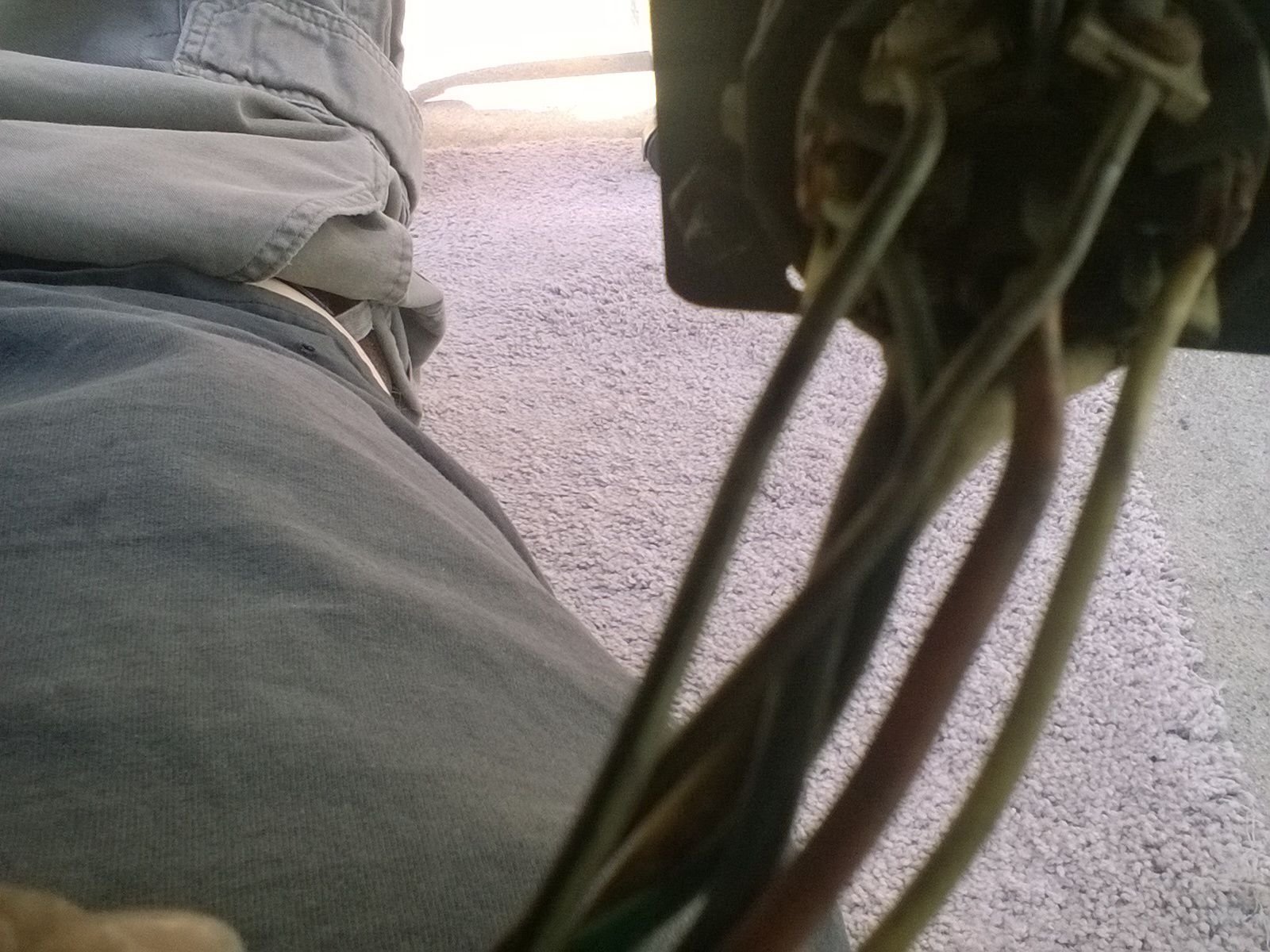

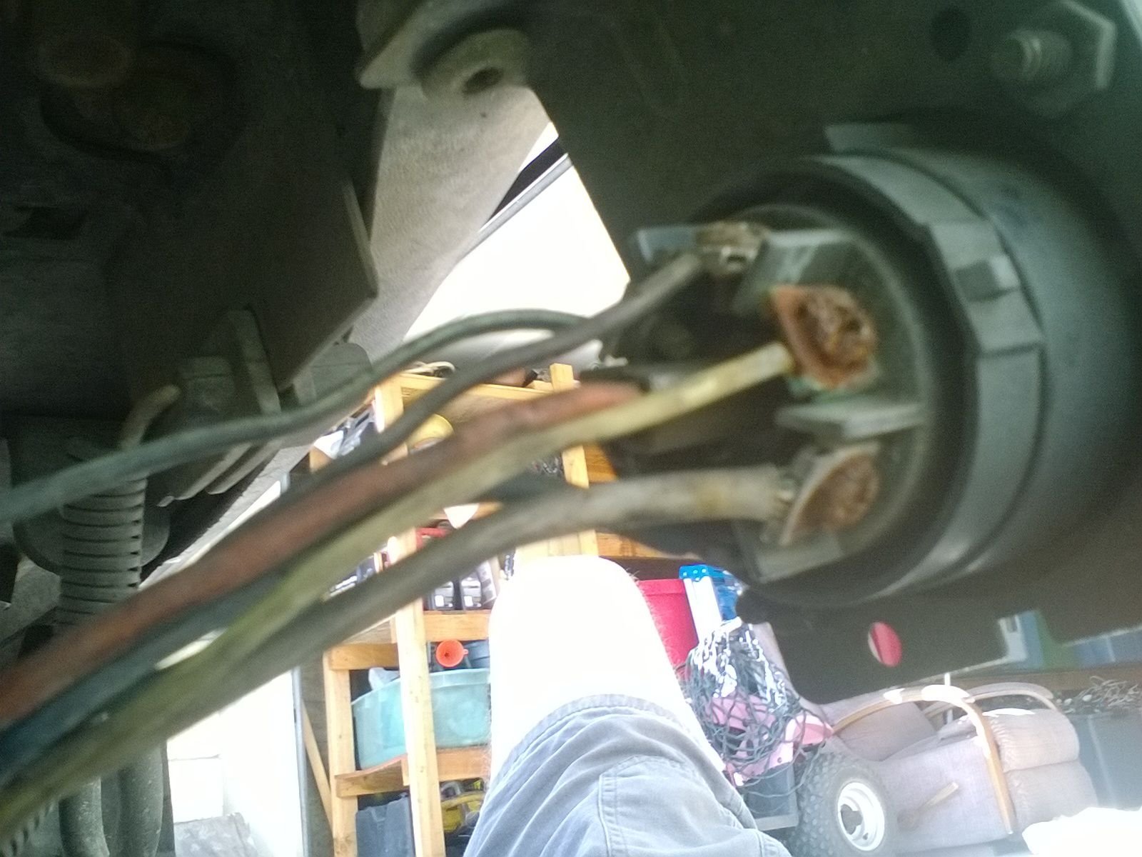

Alright, I pretty much have what the pic description to color wires are, however, my 12v is a sm blk wire and my "reverse" lights at center position is actually orange, not purple. So, what's AUX power? Plus, I'm cutting this up and installing a new 7-plug Say something about this photo

Sorry, since most campers do not have back-up lights some folks wire something else into that terminal hence the name "aux power". It could be anything you want and some folks do use it for back-up lights. When it is wired to reverse on the truck it does not go to anything on most trailers.
Your connections on that seven pin look rough so a new seven pin is a reasonable starting point to get everything shiny and new. I sure you will clean up the wire ends too.
After you get this part done post back and let us know if it made any difference.
Steve

I am not sure if this comment is helpful, but pay no attention to wire color. Go one lead at a time and put it where it belongs. The last one I had to sort out activated the trailer brakes whenever the left turn signal was turned on. Try not to disconnect all the wires at one time so as not to confuse or short a lead and blow a fuse.

That orange lead is large and I think should be the charge lead. I never go by colors, just function. That size is way too big for lights. That lead that is hot in R should go to the center pin. For your charge lead make sure your fuse and relay are in place.
Steve
