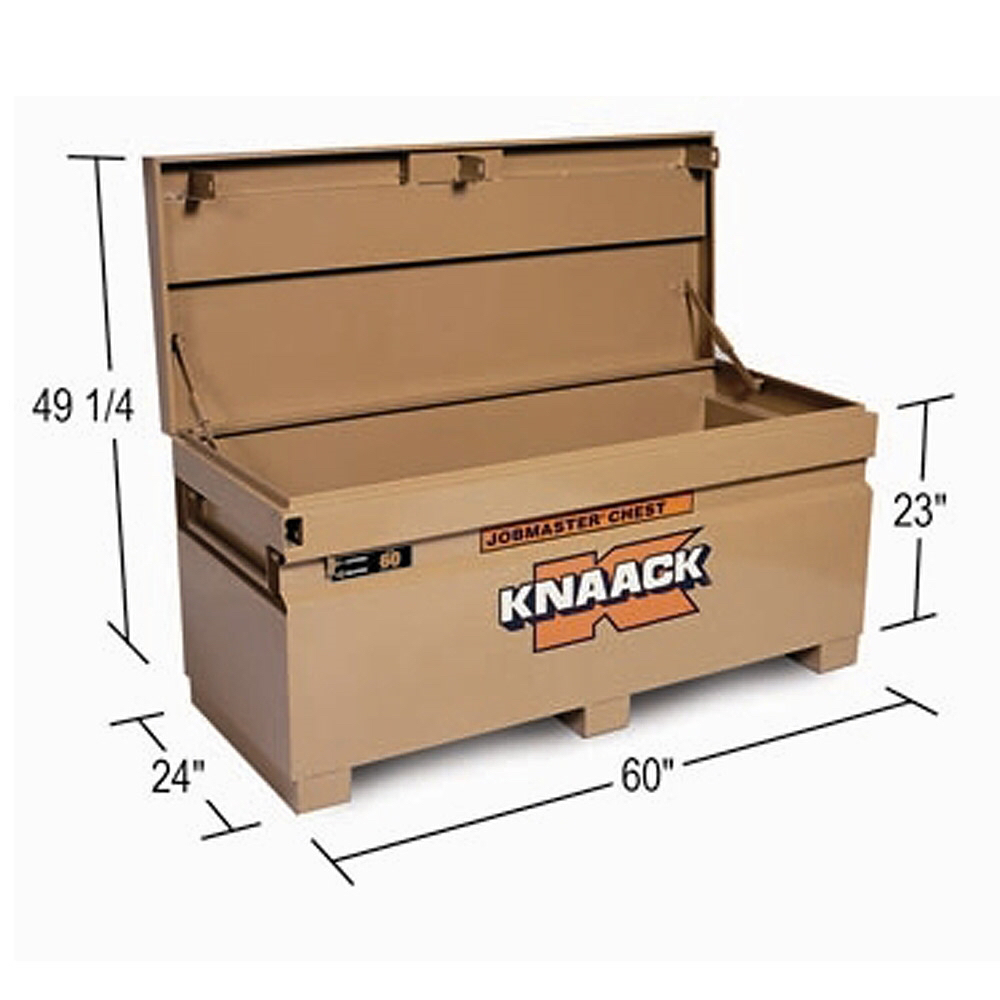

I bought a Knaack 60 Jobmaster.
http://www.knaack.com/en/view/Produc...orage/Chest/60
I then removed the legs, cut the bottom out to lower the toolbox height to the same as my bed rails and welded a new bottom in. Removed the steel hinge and welded a stainless steel piano hinge the entire length. Sandblasted entire box inside and out and had it spray coated in and out with LINEX truck bed coating and then applied their UV Color Stabilizer. I then adhere with 3m 5200 1" PVC on the entire bottom to lift the toolbox away from the truck bed and to allow me to grind the bottom PVC to absorb the truck bed interior radiuses between floor and walls. I securely tightened the pvc to toolbox with SS screws from inside to allow 3m 5200 the seven days to cure and stay in place. I then drilled 8 holes directly through truck bed and through bolted toolbox with Stainless Steel bolts and nylock nuts with washers. Toolbox used to bounce prior with heavy tools 350lbs on rough farm roads. I'm happy I did it, and will do the exact same procedure again when needed.
Model 60 JOBMASTER® Chest, 20.25 cu ft
Attachment 171174
Everything about this build sounds awesome and seems like that would be a great tool box to last a long time. Did you do anything to assure the stainless steel bolts won't corrode the aluminum bed? Rubber gromets at the bed holes? Even a good coating would help. I see you used the nylon washers so that cuts back a lot of contact already.
