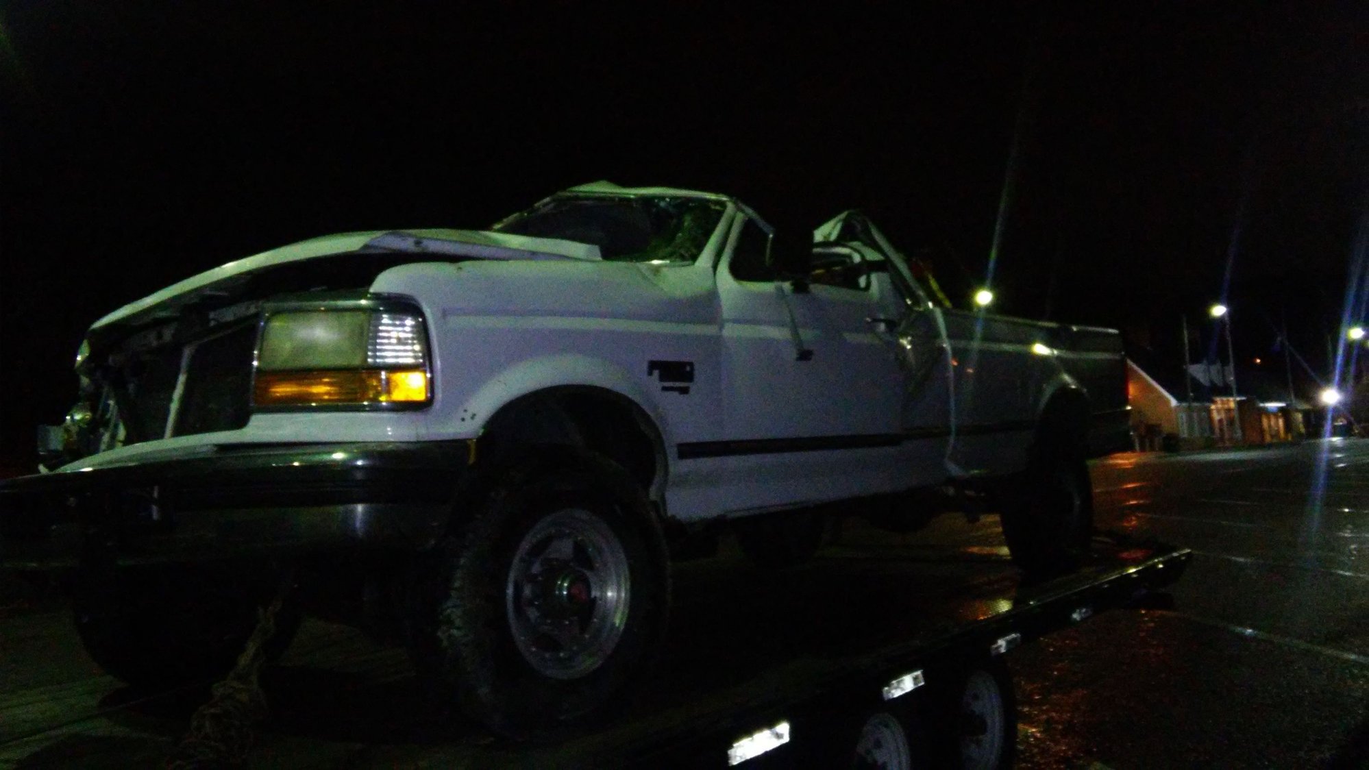

I acquired a 5-speed donor and a lesson that you should always set your parking brake as this gentleman did not
