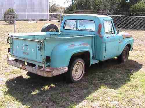

I had no idea about the `79 frame but keep in mind the top edge of a flareside box changed in `73. The `53-`72 has the top edge on a 45 degree angle and the `73-`79 is flat to allow a canopy (topper) to fit on properly.
1966 box
1979 box
Old Jan 2, 2017 | 09:52 PM
