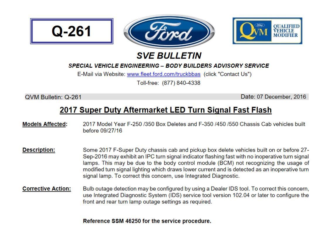

I have the LED bulbs installed in the reverse lights and they are awesome! I also did the brake lights, they seem brighter than the stock ones. I cant get the tag lights in just yet my hands are to big to reach in behind the bumper and hitch, so those will have to wait till spring. Only complaint is I have a hyper flash on the dash display when turning on a signal. The lights don't flash to fast just the dash display does.
With ForScan you should be able to modify the code to stop your Hyper flash. All the truck is looking for is an active amperage and these new LED's draw much less current so it triggers the hyper flash since it feels the lower amperage means a bulb is out.

Your dealer can fix this as well.

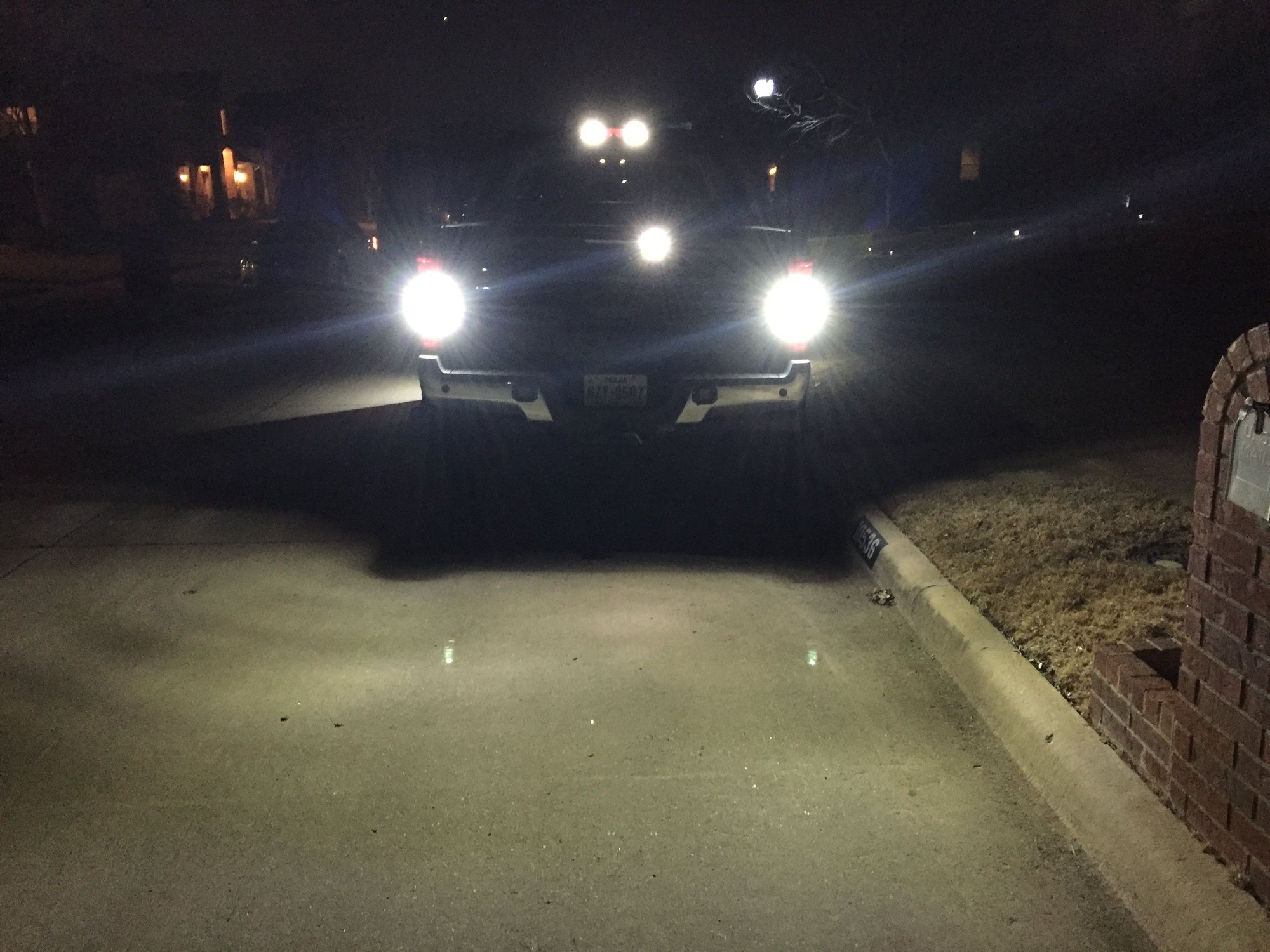

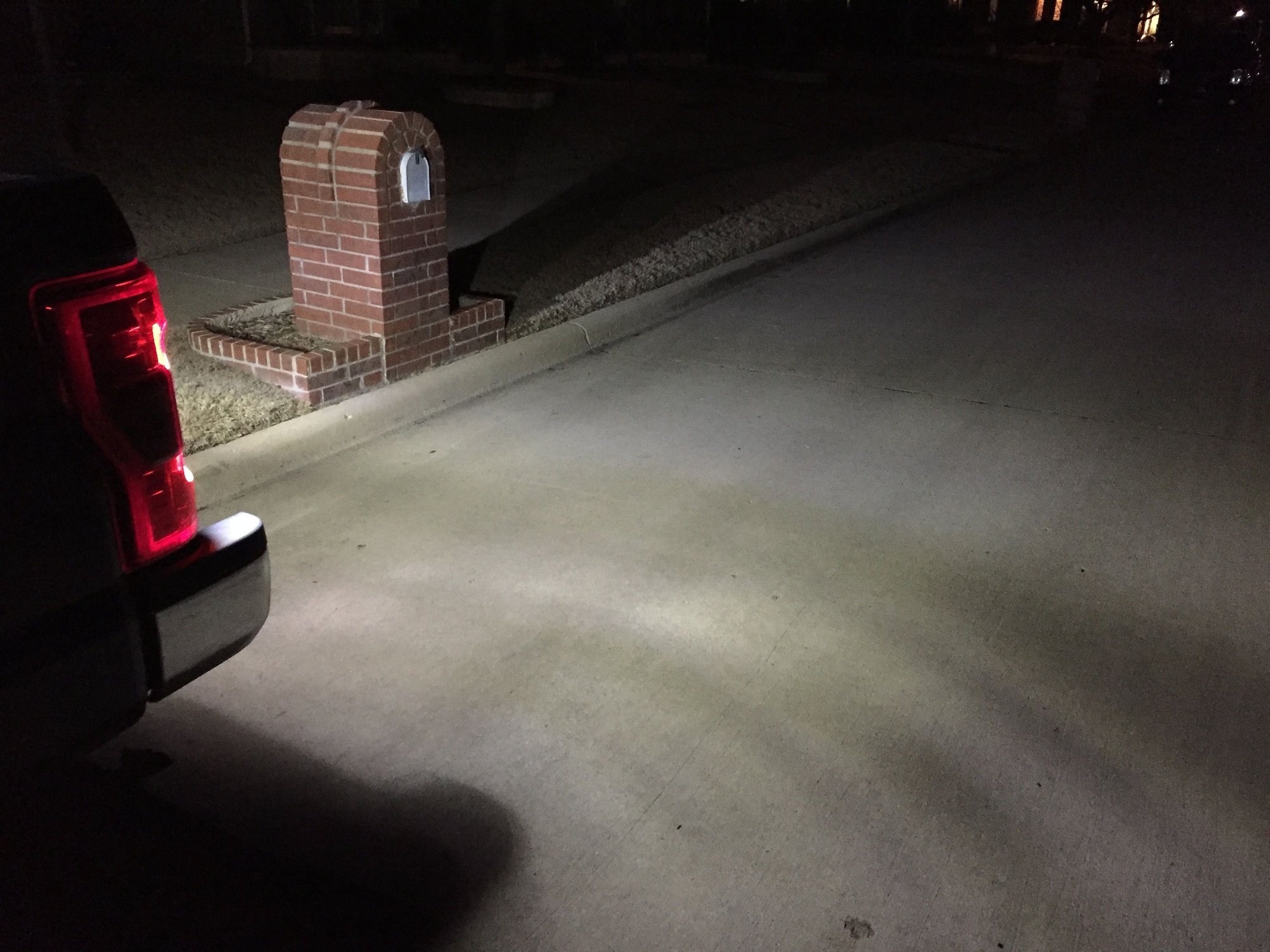

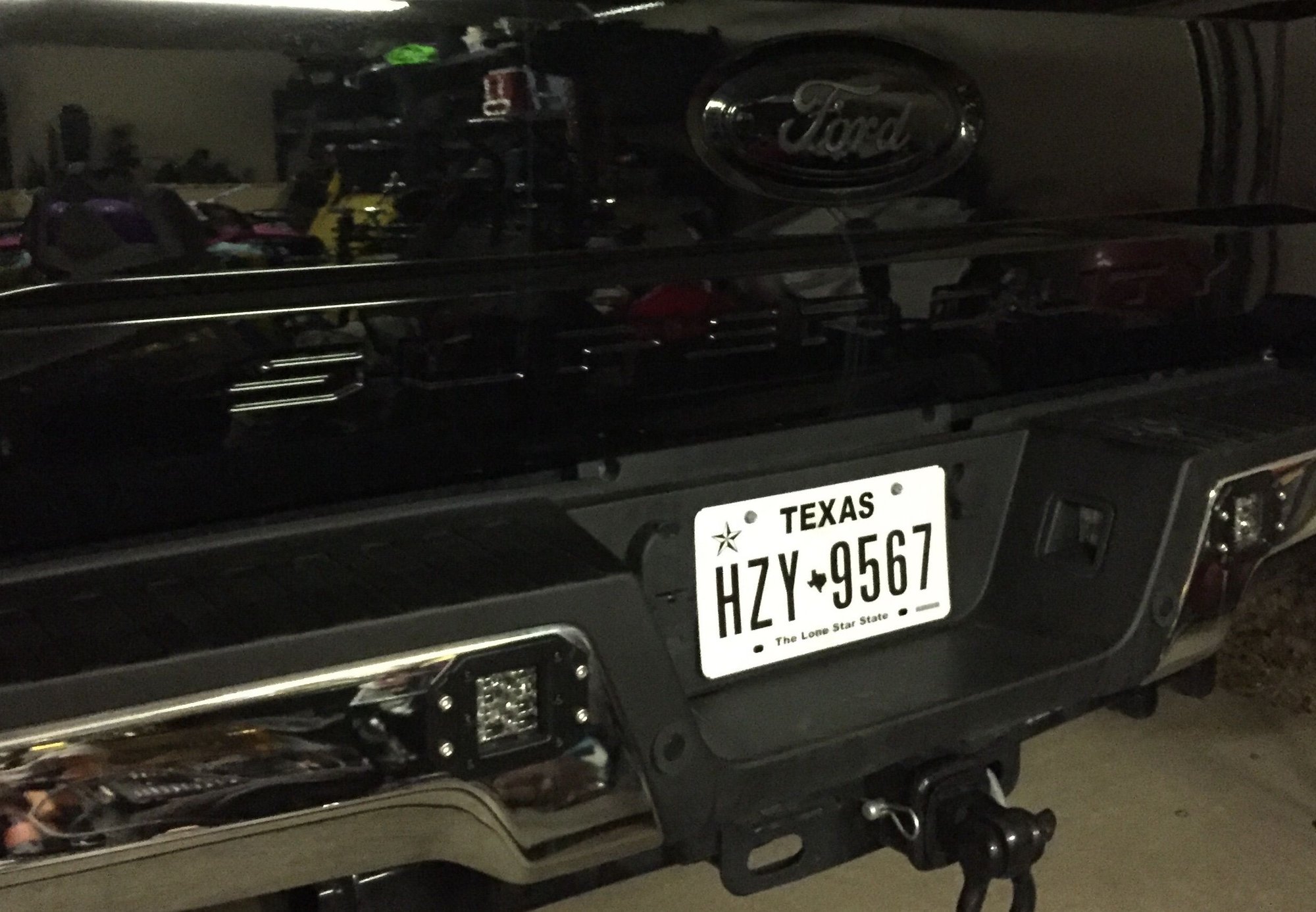

SkiLine00 are those flush mount leds in your rear bumper?? I had those on my 2012 and want to put them on the 2017 but didn't think they would fit...Please advise on the subject.
Yes sir, there's not many places to mount them on the new bumpers, but they fit in the upper inside corners nicely.

How hard was the install?? Did you pull the bumper to do it?? For wiring did you run to a upfitter or tap the tail lights? I tapped into the taillights on my 2012 and had no issues for 4 years. Mine were auxbeam or something like that.....
Not bad at all.. I made a template out of cardboard, masked off the bumper, and transferred the template to the masking with a sharpie. I used a roto zip to cut the holes out, I probably had two hours total in it. There were some wires behind the bumper that I had to zip tie out of the way, but nothing else to interfere. I didn't remove the bumper, but that would have made bolting the lights in easier. Wired them to upfitter Aux 2, it's nice being able to turn them on independently when I want...

Mine are made by "Off-road Town", their a cheap $50 pair of Amazon lights, but they're bright and durable.. I had a set on my 15 for a couple years and never had an issue. I have a buddy that has a pair that he paid 6 times what I did, we had them parked next to each other and we couldn't tell a difference. He wasn't thrilled about that, haha!
