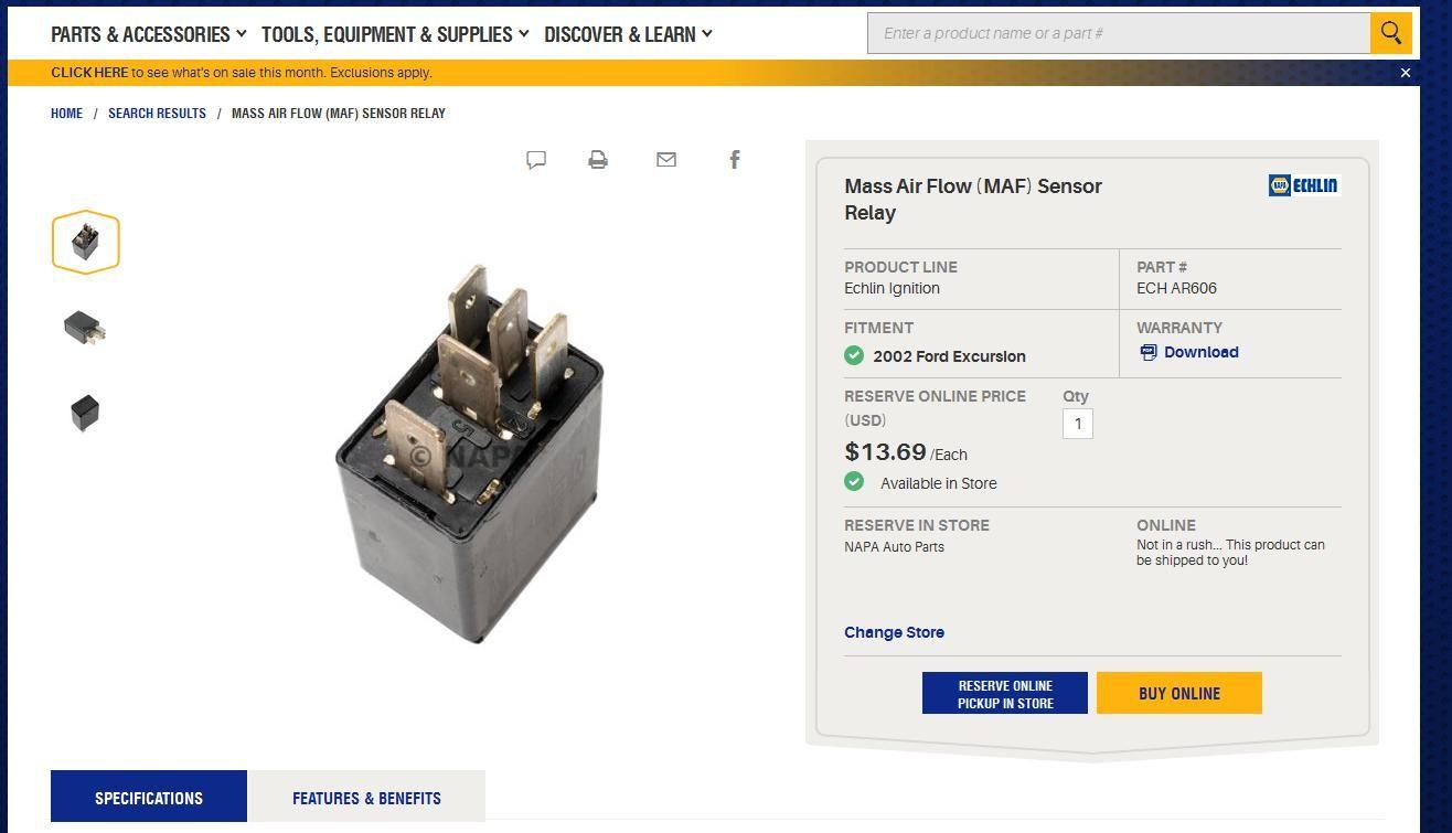

Upon looking at NAPA's website, I noticed that it lists an MAF relay in addition to the sensor itself. Since the relay is 1/10th the price of the sensor, and relays go bad as often as anything else, I was willing to spend (possibly waste) $16 to keep from having to pierce those wires. The proble is that I have no idea where that relay is, and a search of "MAF relay" & "V10" on this forum gives me zilch. The relay doesn't look like any of the relays in the fuse panel below the steering column.
Is NAPA full of it? Is there such a relay in this vehicle? Ironically enough, changing the vehicle to an F-250 instead of an Excursion makes the relay disappear from NAPA's parts list. I would have thought if the V10 Excursion has this relay, then a V10 F-250 would too.

There's no such thing as a "MAF Relay" on any Ford vehicle.

Thanks, projectSHO89. I thought something was fishy, since I couldn't find a single discussion about such a relay.
Here's a screen shot of the NAPA page. I guess I'll be piercing those wires, or at least trying to clean that sensor...

I guess the PCM relay is what they're selling. I assume if that relay goes out, the vehicle won't run at all.

... I assume if that relay goes out, the vehicle won't run at all.
Correct.
The NAPA relay pictured is not the PCM relay used in 2002 - it is the other configuration.
