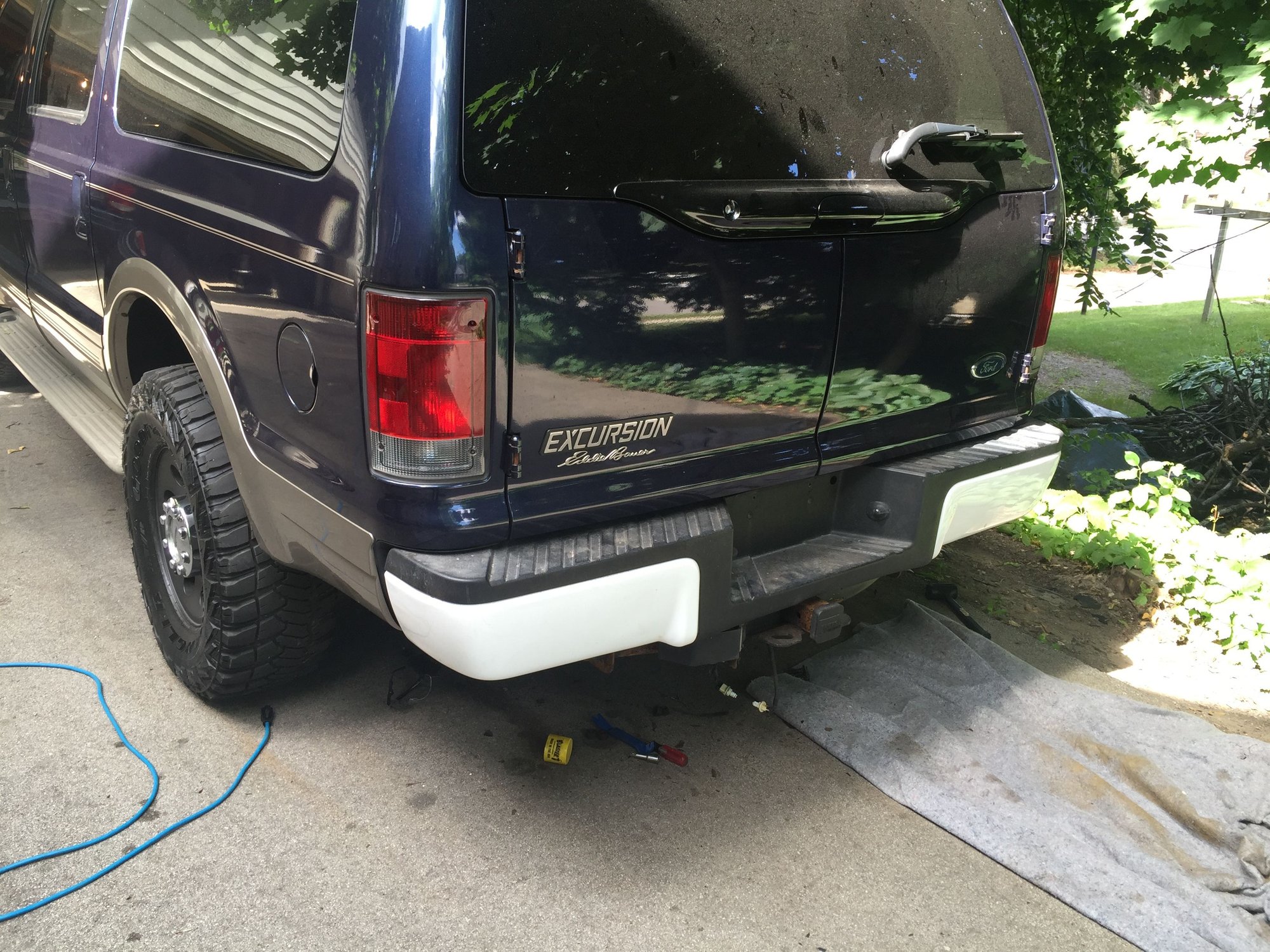

I need to add back up sensors to my rig..I see that you had a newer style bumper and added them, do you have any tips for me?

I bought a sheet metal drill bit set and gradually bored out the holes. Factory sensor plugs from my 05 didn't point out straight/level so I bought 4 new sensor plugs from Ford for $20 a pop off of a 2015 abd '05 sensors fit right in.
Rather than find a way to notch the holes to fit the tab on the sensor plug (there so sensor plug doesn't spin) I trimmed the excess plastic off and slid them in the holes. So snug that they cannot spin.
Estimating exactly where to cut and actually drilling the holes took the longest because bumper is pretty thick.
Hope that helps
Use a metal file edge (the narrow side).

Forgive my ignorance. Is that a 2004-2008 F150 rear bumper?

It's off of a '12 F250
