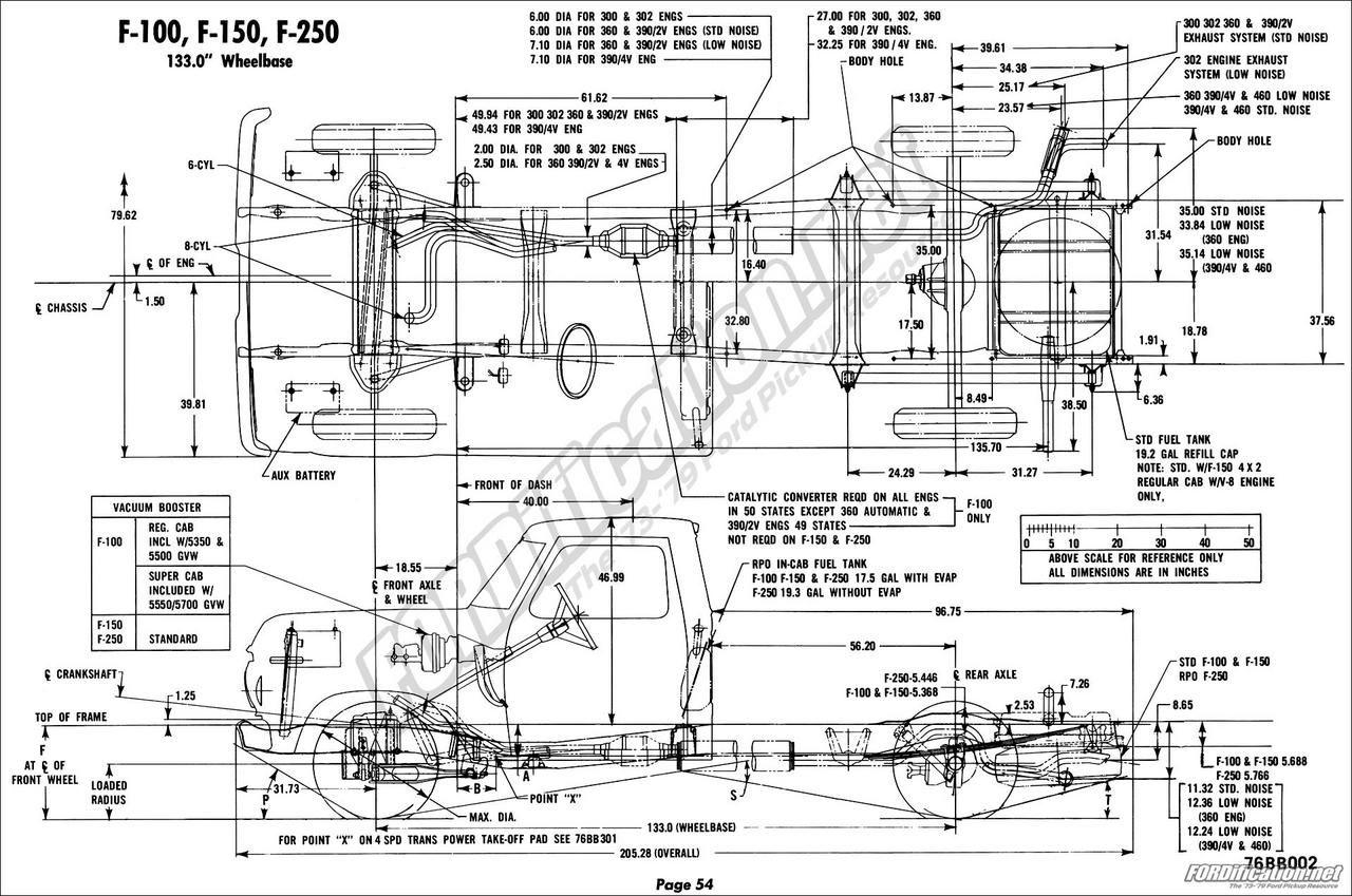

Below is a basic example... the 37.5" chassis depicted is a F100/150 type but the 2wd and later 77.5-79 D60s fit in place of their 9" rears as they share the same springs and measure in the rear.
67-77 F250 with 34" rear frame and 3" springs
73-79 2wd, 72-79 4x4 F100-150, and 77.5-79 F250 4x4

33 1/2" width between the inner frame rails behind the cab:
1961/72 F100/350; 1973/77 F250 4WD (High Boys); 1973/79 F350 Crew Cab & Regular Cabs on the 140" wheelbase.
37 1/2" width between the inner frame rails behind the cab:
1973/79 F100/150 2WD/4WD & F250 2WD; 1977/79 F250 4WD (not High Boys); misc. F350's.
