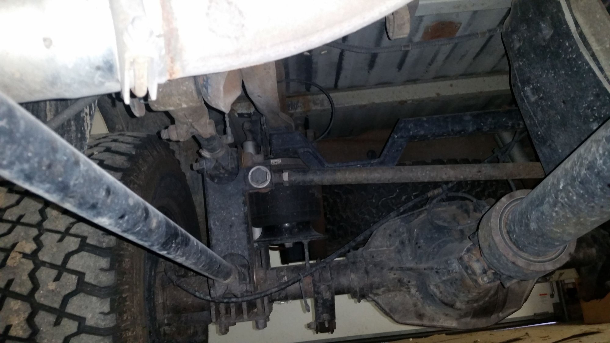

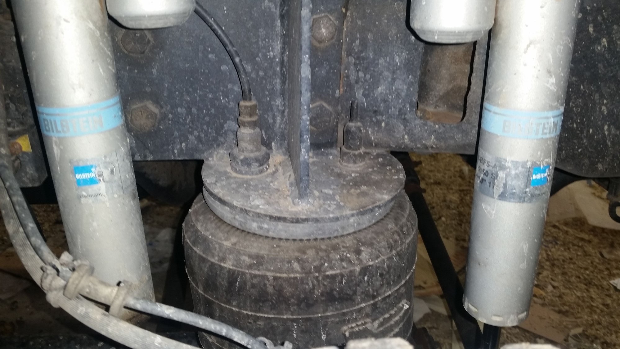

I was asked to post a picture of my air tank. Pictures to come. It's easier to upload straight from my phone. I'll edit this post afterwards.

BA suspension ya got there. Is there a ride height switch in the cab?

Does it ride any smoother than with leaf springs.....???

There's an on/off switch in the cab as well as an up/down switch. The pump is in the box shown, just behind the transfer case.
I usually ride about mid height. A much better ride than leaf springs. Handles loads without notice and tows well. Nice on dirt roads and for getting around the property.
Haven't done much off roading and I really haven't really used it to it's full potential.
New, it came close to $10,000 for front, back, and on board pump. One of the advantages of buying a used truck. I didn't pay for it. On the downside, I'm getting a slight clunk in the front end. Trying to figure it out. Haven't found anything major. Just a little more complicated. Something I would dream of, but never buy due to the expense.
Yes, they drilled into the frame. It's attached to the flange as well. Done by the original owner when it was new, there are no signs of frame fatigue.
I do get a lot of comments, especially when I pull out the stepladder to get mom in.
Looks like undercoating may be my next project.

Thanks for posting more pics on your Kelderman full replacement air suspension system! Thanks also for your real world impressions. Reps sent.
