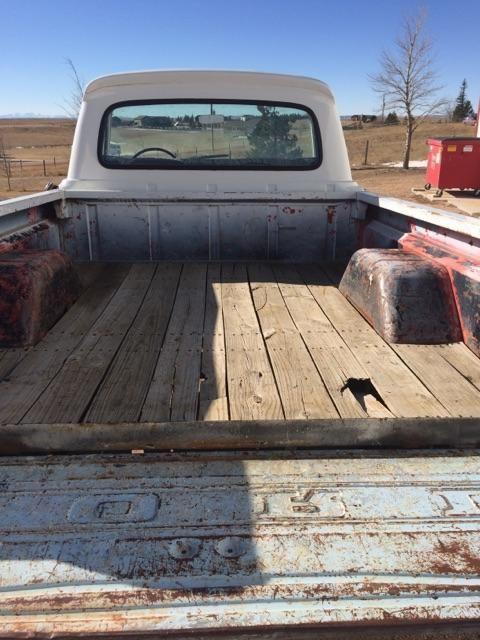

The guy told me that the grill was from a 65. I didn't know the difference in fender emblems.The truck has rust in the cab floor and in the bed around the wood. Everything else is pretty much rust free.Has some wiring issues that shouldn't be a big problem with you guys help. lol.

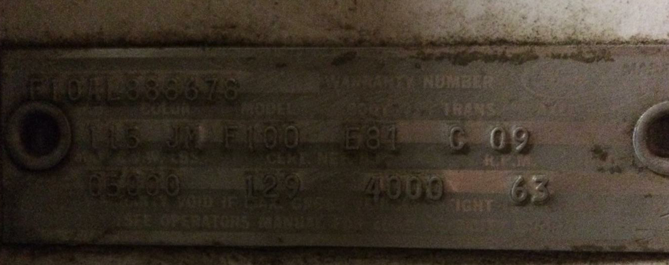

I will try to get a picture of the V.I.N.tag from him.
styleside beds don't have wood from the factory so somebody has 'customized' it...be careful, the wood may have been added to hide some extensive rust in the floor, which might still need fixed to keep the bed structurally sound.

Really? Stylesides do not have wood floors. I thought it was an option.

VIN Tag.It says it is a 66.
No Styleside of any year has a wood bed floor, only Flaresides did.

The tailgate reminds me of the type used on 1967-1972 trucks. The letters "F" (not seen in your picture), "R" and "D" are shaped a bit differently with the serifs.

Thanks guys for the enlightenment. I knew the tailgate was incorrect. When I drove to Cheyenne to see it. The guy had cut a piece of diamond plate and tacked it in. I could see the edges of the bed. They all looked good. I looked under the truck and the supports all looked good. When it gets here, I am sure there will be surprises.
