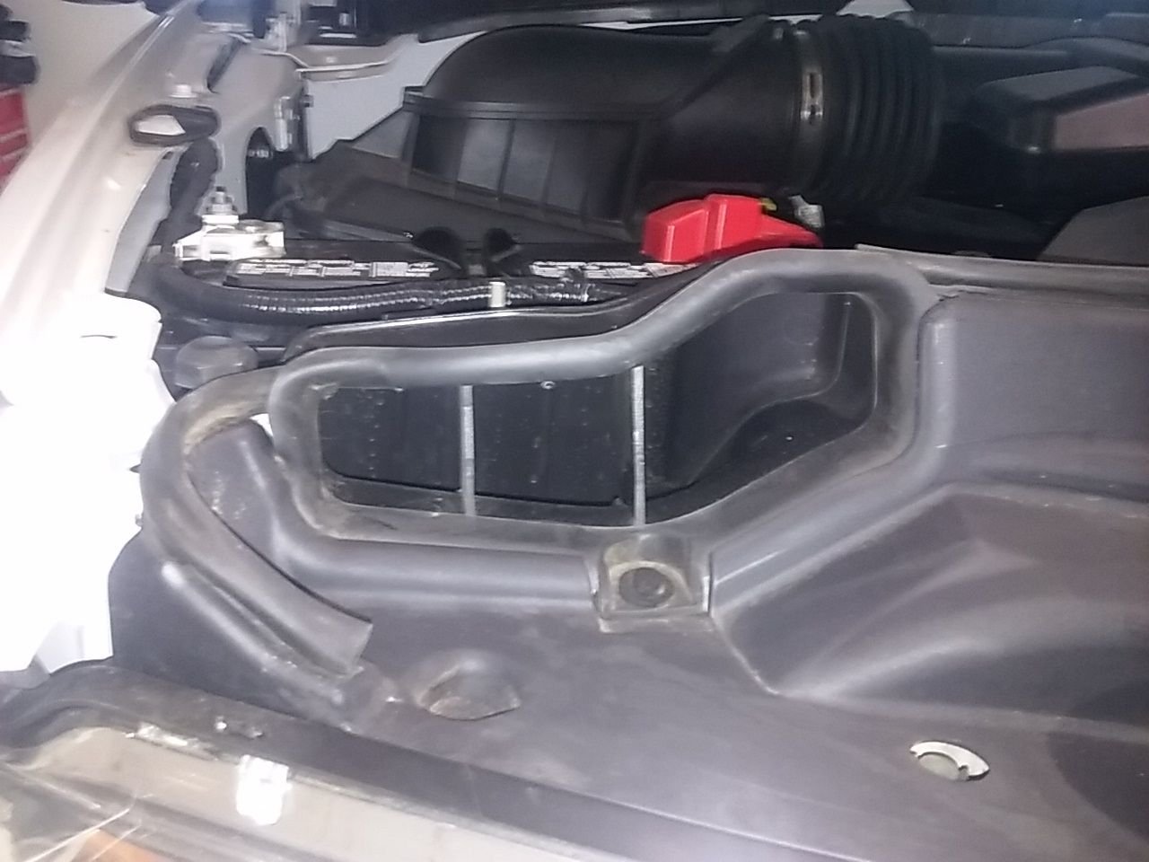

It could be either something rotating on the front of the engine as you suspect or it could be air leaking into the intake parts (air filter box etc). Maybe you could put your hand around some of the ducting and boxes or give them a little push here and there to see if you can make the noise change.

Mine used to make a whine at cold temps but only at certain RPMs and only until the engine warmed up. I was told by Ford it's the way the cold air goes through the intake. Truck only made the noise the second winter I owned it though.

I have read the whine is attributed to the air intake when temps are cold. This could be part of the reason why the new intake is totally redesigned on my 2017. I have not had the whine, I started my truck in single digits last weekend, no noise.
