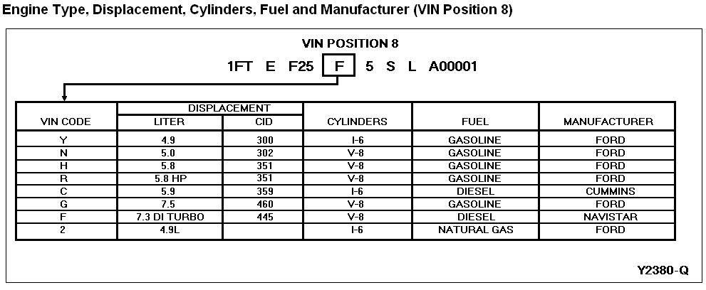

Does this truck have an inline 6 cylinder (4.9L) or a V8? If the latter it's most likely a 351 (5.8L). As previously stated I have never run across a F350 of this vintage with a 302 (5L).
The 8th digit of the VIN contains the engine code of the vehicle as it was manufactured by Ford:

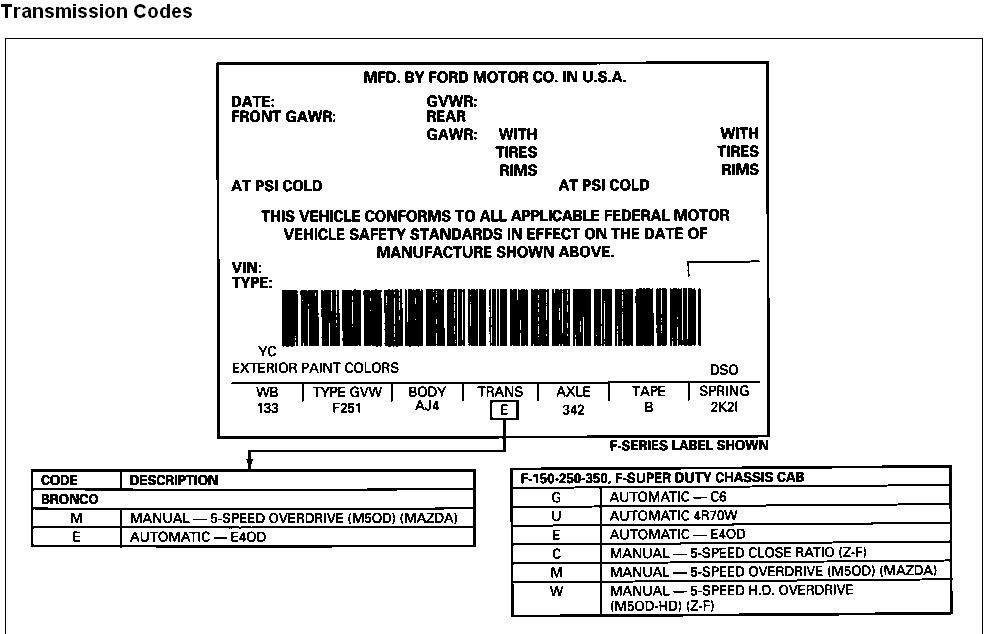

If the truck did have an overdrive transmission (E4OD) there would be a button on the end of the shift lever and an O/D symbol on the **** that lights up when you turn off the overdrive. Somewhat common for these F350s to have a 3 speed C6 automatic transmission.
Check the sticker on the driver side door pillar for the transmission code. Trans code E is an E4OD. Trans code G is a C6

Ok, once again you are correct. It is definitely a V8, but I assumed (I know, we don't need to go over the ramifications of that) it was a small V8 due to the seeming lack of gusto.
However, I dug out the title as the stickers on the door are faded to nothingness. The code is H so it is the 351!
