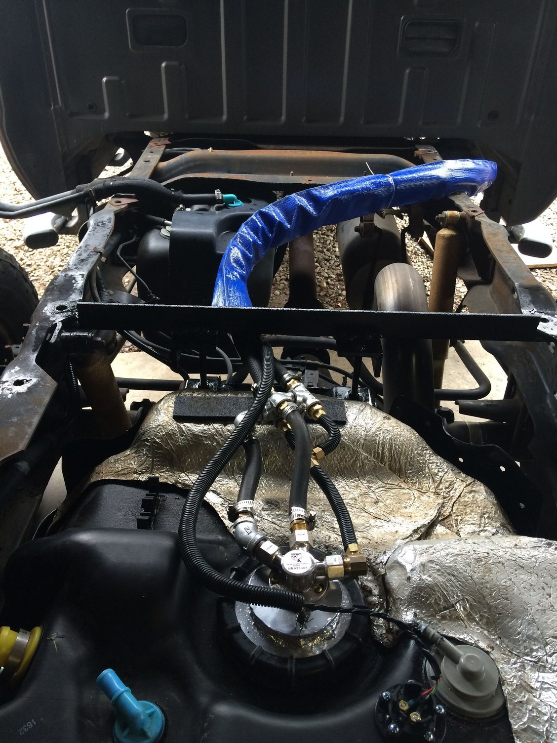

Excursion fuel tank for WVO with Hot Fox heated fuel pick-up, ISSPRO fuel level sending unit and you can see the terminus of Tube-in-Hose (TIH) heated fuel lines.
Moving forward, you can see the other end of TIH and the Racor pS120 pre-pump filter.
Then you can see coolant shut off valve, aux coolant pump and Bosch SD fuel pump.
Fuel pressure regulator is before VO filter with copper coolant wrap, then the VO-side check valve and a purge valve.
