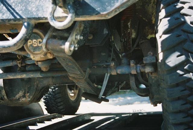

Look close at these lower control arms
Note the nylon ties holding on the lower leaf spring
