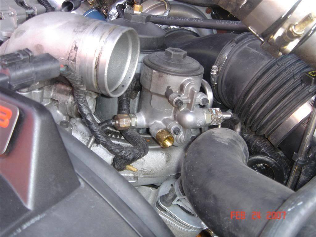

There's a fuel pressure test port in the upper fuel filter bowl. You just un-thread the plug and thread in the test adapter. Have petroleum compatible teflon tape handy, you can get it at Lowes/Home Depot. It's yellow in color and inexpensive. You can get a loaner tool from a parts store to test fuel pressure. They usually have a not-cheap deposit, but you do get that back when you return the tool.

Here's a picture of the fuel pressure test port location. It's on the upper filter; brass fitting already installed in this pic.
