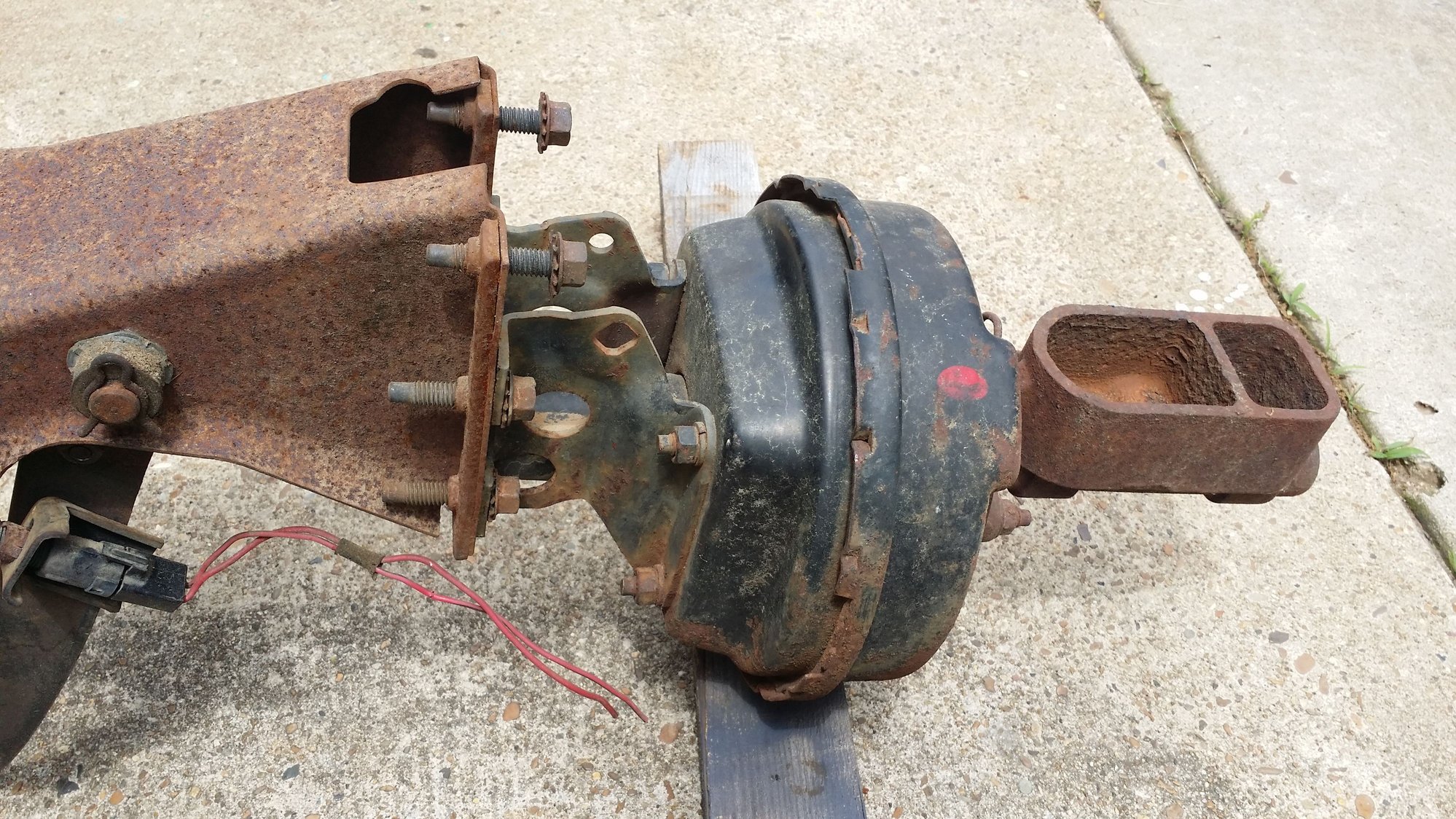

Brake Booster/Brackets Mounting Hole Dimensions
If the four hole dimensions on the firewall (where the booster brackets bolt up) are 2-1/8" vertically by 3-5/8" horizontally, a '68-'77 F100, F250 or F350 booster would bolt up to the Slick.
The only other factor would be the length of the input rod running from the attachment point on the brake pedal to the back of the booster. On a '68-'77 truck, this length (for a non-bellcrank [cantilever] bracket assembly), from the back face of the bracket, where it interfaces to the firewall, to the center of the input rod eyelet is 5-5/8" in length.
The '68-'77 hole pattern (where the booster studs would attach to the firewall brackets) is 3-5/8" vertically by 3-13/16" horizontally.
I installed a dual diaphragm booster/firewall mounting brackets in my '69 F100 that I pulled from a '75 F350. --I originally had manual 4-wheel drums but converted to front discs from a '77 model F100.
It's probably best, if you have drum brakes at all four corners, to run a single diaphragm booster and not the more powerful dual diaphragm version. Otherwise, you may have very sensitive brakes. Drum brakes are self-energizing. Discs aren't.
The '68-up single diaphram boosters are not very different from the boosters that were available in the Slicks. If the dimensions I listed are the same for a Slick and a booster for a Slick cannot be located, the later model boosters would be an option to have a power brake booster in the earlier model truck.
This is a single diaphragm (non-bellcrank bracket assembly) booster from a '68 F250. You can see the bracket and booster design is very similar to the OEM booster/brackets that was previously posted for a Slick.
Single diaphragm booster from a '74 F100.
