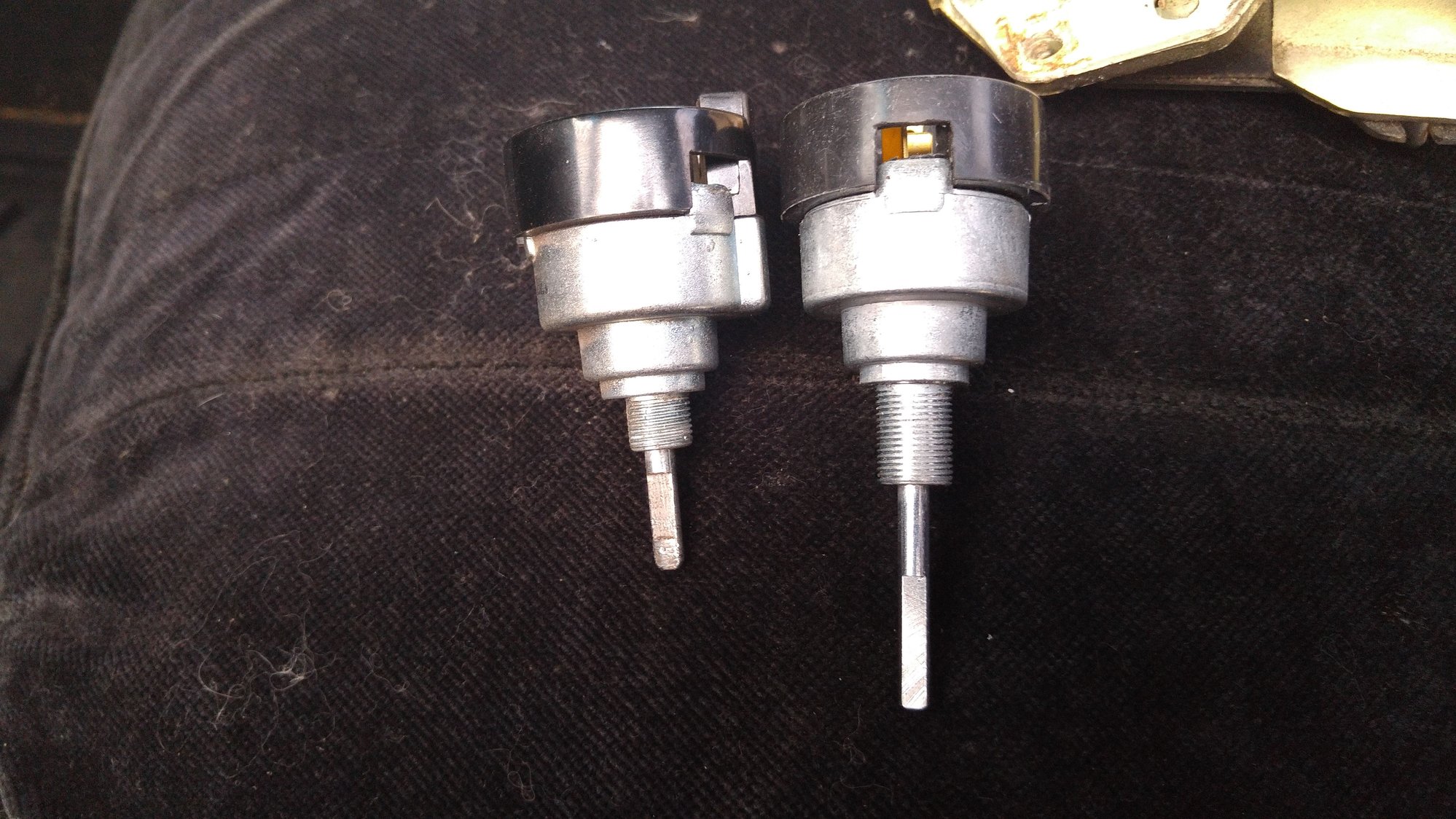

I went out there last night, check the fuse and that was good.
I turned the switch on and I put light pressure on the arm to see if maybe the motor is getting weak and that didnt do anything.
I dont want to just buy a new switch (Part store want $70) but I'm going to take it out and measure resistance to see if it bad.

I used a jumper wire to bypass the switch and test the motor. Motor was good, switch was bad.

I got my new switch in. Looks a bit different. But the wiring and plug is all the same. I hooked it up and Still didn't work. I was turning the switch and nothing. I started my truck to warm it up later and I must have left the switch on. My wipers were in the middle of the windshield. Slowly moving. I started driving and they eventually started working. They work every time now. I guess my motor must be weak.
