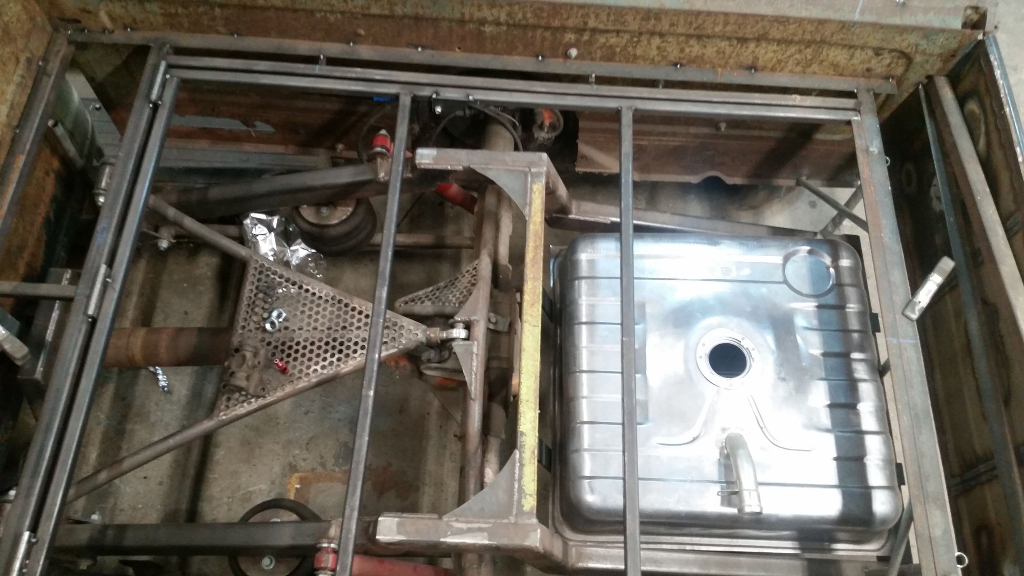

bed mounts
I'm currently working on mounting the bed to the frame. Im building custom brackets and wondering; does anyone here use rubber isolators for their bed mounts? It seems it would help with vibration but I don't recall any OEM vehicle I've owned using them.
Old Feb 14, 2017 | 09:39 AM
willowbilly3's Avatar
willowbilly3
Joined: Jun 2003
Posts: 8,209
Likes: 12
From: Black Hills of SD
I think some rubber would be fine. On my 29, I used some rubber belting that is about 1/4" thick and used a hole saw in the drill press to cut some big rubber washers. I made my engine mounts and body mounts from those, worked good.

Thanks Tacoma. I dug out a few rubber strips I had stashed a while back. I'm going to try em out for size.

I found some of the rustoleum clearcoat in satin and sprayed a few random objects I had around just as an experiment. We'll see what kinda results I get.
I just got the bed mounted up with some custom made brackets. I put up a video, Check it out!

I have been watching your videos! The use of rubber isolators when you mounted the pickup bed is definitely better than the wimpy stock pieces. I am really in awe of your shop and your fabrication skills.

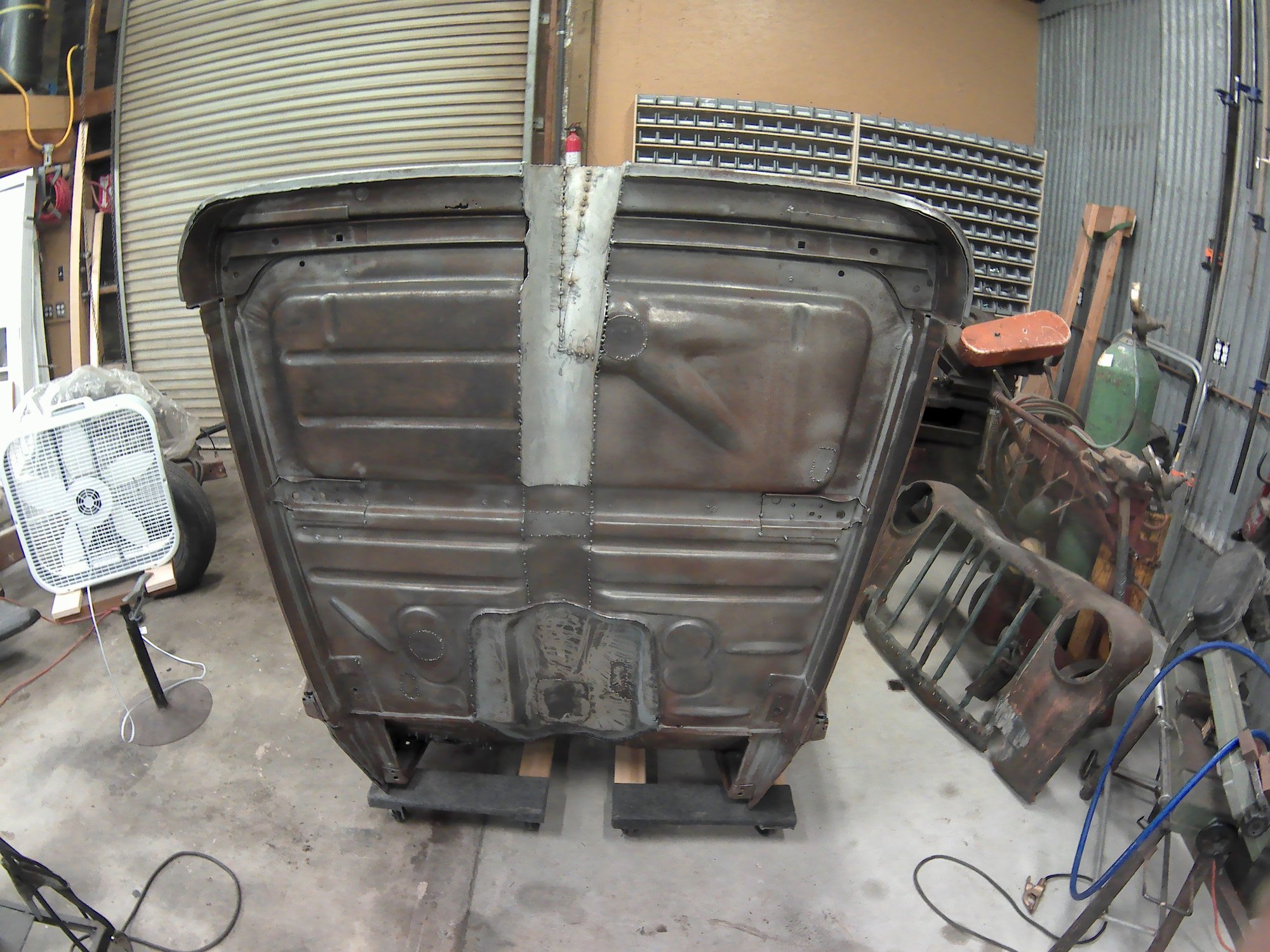

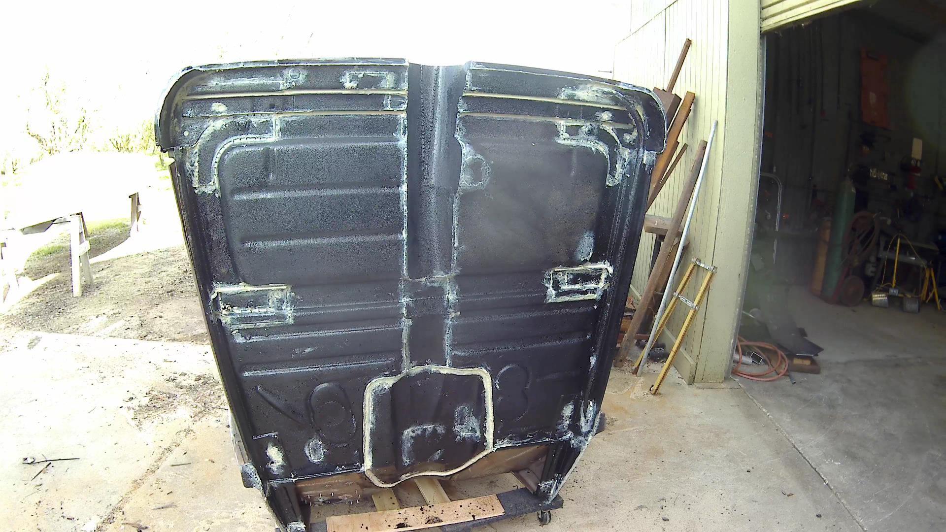

I just finished work on the bottom of the cab, Im very happy with the results. I did some metal repairs, rust eradication/prevention, seam sealer and some heavy sound/heat control coatings. Im getting ready to start on the bedfloor. I have some old barnwood that Ill be using.
