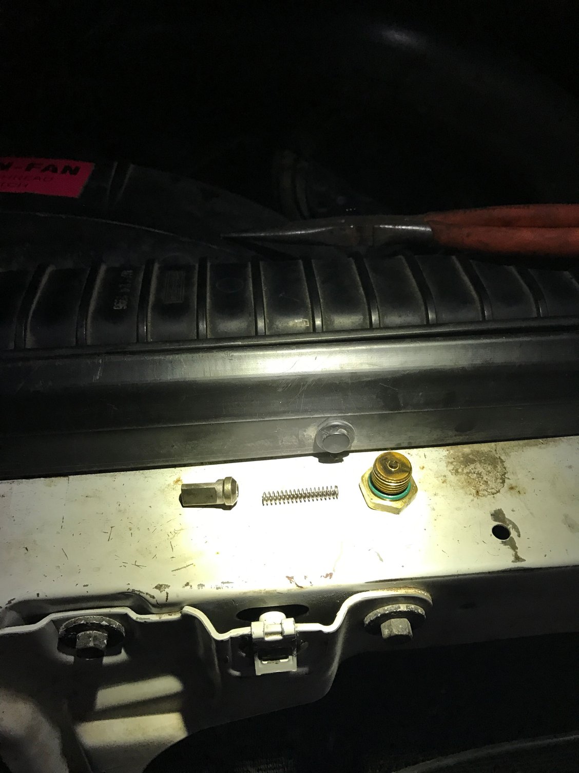

Am I missing anything for the FPR? I thought there was supposed to be a plastic ball inside?
Old Dec 24, 2016 | 06:44 PM
farmert's Avatar
farmert
Joined: Mar 2006
Posts: 5,111
Likes: 1,546
From: western SD
It's been a while since I have had one apart, but I think that triangle shape piece should have a pointed plastic piece on the opposite end the spring goes in to.

I have 20 psi coming out the shrader now.It took a little cranking to build it.the truck still won't fire.

I thought there was a little white colored plastic ball to act [I think} as a check valve ?It,s been a least 5 years since I had mine apart. When I changed my fuel filter last week It fan for maybe 25 to 30 seconds & then died. Just as if I had turn off the ignition key. I finally found a used Idm @ a wrecking yard & installed it & it started up so quickly it shocked me. Now, I had checked the Idm by shaking the heck out of it but could not hear any water in it. So now I,m a happy camper. Friskyjake
