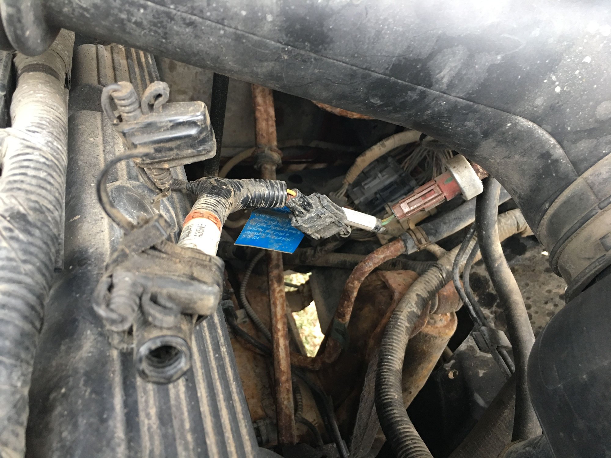

The wiring from the switch on the brake master seems off to me- anyone confirm this looks right?

That pic above isn't the switch for brake light, that is under the dash.
What you do have in that pic is a factory recall issue that has been fixed (by adding fuses, it is for cruise control). And a lot of rust. I'd definitely closely inspect your frame/body grounds.
