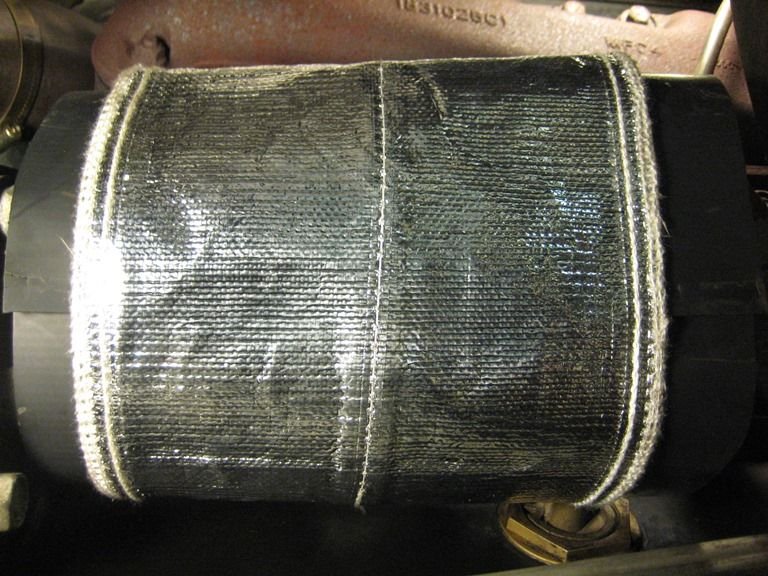

Originally Posted by SpringerPop
My local shop tells me that the OEM PLGR unit has very hard brushes and commutator ring segments, and last an incredibly long time. What almost always is the problem is the solenoid assembly that's a part of it. It's available separately (LINK), and combined with adding some grease to the planetary set, is all that's usually necessary to double their useful lives.
This is the same reason why I wrapped my starter in foil covered fiberglass, to protect that solenoid assembly from the heat of the exhaust manifold collector directly above it. Not sure if it does any good or not, but I'm still on my original 3 bolt Mitsu. If nothing else, the wrap keeps the starter very clean and shiny!
I first put the wrap on about 15 years ago. I just recently replaced the wrap with a new one. The heat down there was brutal enough to eventually melt the adhesive of the original wrap to the point of disintegration. Just think if the solenoid had been exposed all that time to the heat baking and brittlizing whatever conformal coatings are inside that solenoid to isolate circuits.
I adhered the old aluminumized wrap to a sheet of insulating rubber, since the wrap was conductive. The new wrap uses sewn in, sturdily stiched Velcro instead of adhesive. I still kept the rubber insulator, which survived likely due to the protection of the old foil/fiberglass wrap, and put the new Velcro foil fiberglass wrap over it. If it lasts another 15 years or so, that'll suit me just fine.

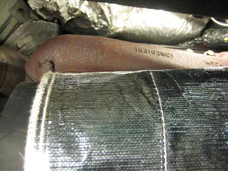

What a good idea!
Can you elaborate a bit of what product you used as a wrap, and the rubber?
No, don't go getting photos. It's COLD outside!
Originally Posted by Firefighter 1406
I would like to see the pictures as well.
As requested...
You can see the rubber insulator peeking out in front of and behind the stitched velco foil fiberglass starter wrap. This is version II. On the earlier version that held successfully in service for 15 years, the foil fiberglass wrap was self adhesive, and covered ALL of the rubber, end to end. But recently, the adhesive finally gave out, no doubt due to the heat from the close proximity to the collector end of the exhaust manifold, combined with my larger downpipe, a little bit of which can be seen in the upper left hand corner of the photo below:
I'm glad all that heat was cooking the foil fiberglass adhesive, instead of my starter solenoid. If you look above the exhaust manifold, you'll see there is a lot of other foil under my hood. Looks a little bit like the space shuttle. Since foil is a very effective radiant reflector of light and heat, I liberally leverage foil's natural characteristic to keep heat away from wherever I would prefer it not soak in. The starter solenoid was one of my targets for a little extra protection, harkening back to the days of no hot starts in my van of the late '70s.

As for the rubber insulator, it is entirely V grooved across it's entire face on one side... the side you cannot see. That's because that side is the inside of the "cylinder" that is formed around the starter. You see the outside of that "cylinder", where the rubber is smooth. Why? I selected V grooved rubber so that the insulator would more naturally want to stay closed into a cylinder. The V grooves provide all the "relief cuts" needed for the net thickness of the rubber to collapse tighter on the inside than on the outside of the wrap.
This V grooved black rubber material is actually commercial floor/carpet runner, and the grooves are non-slip, feet wiping, water routing channels. I also use this mat on top of my tool carts, as it is more durable than the stuff the tool cart companies sell for their tool carts, and the grooves permit oil drippings to drain away from tips of the Vs, where new things can be set on the cart and remain more or less unaffected by the oily things that were resting there before.
