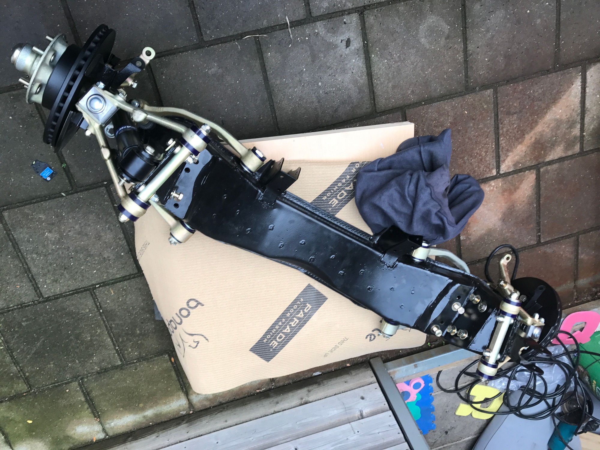

Old Dec 18, 2016 | 09:53 AM
Björn's Avatar
Björn
Joined: May 2010
Posts: 688
From: Netherlands
the jaguar ifs works great
Gonna put it next week under my 56 chassis
Old Dec 18, 2016 | 05:11 PM
Jimmiej08's Avatar
Jimmiej08
Joined: Dec 2016
Posts: 48
From: Old Town fl.
Björn can you post pic for me plz.
Old Dec 20, 2016 | 10:57 AM
Björn's Avatar
Björn
Joined: May 2010
Posts: 688
From: Netherlands
