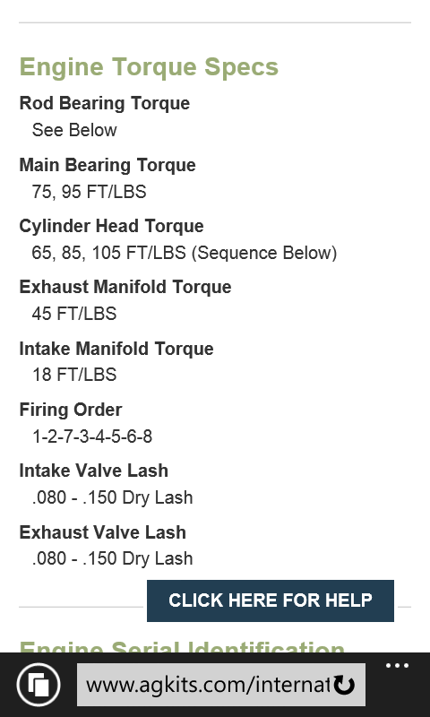

Say something about this photo
Nick, besides the spring themselves and the shims, was there anything else in the "kit"...aka, buckets, caps..etc?
Found this last night....

The question I have is this. How are you planning on adjusting the valve lash? Shimming the springs is not going to change the lash.
