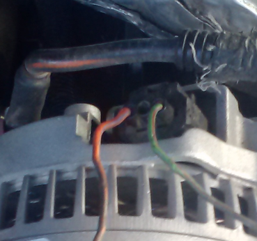

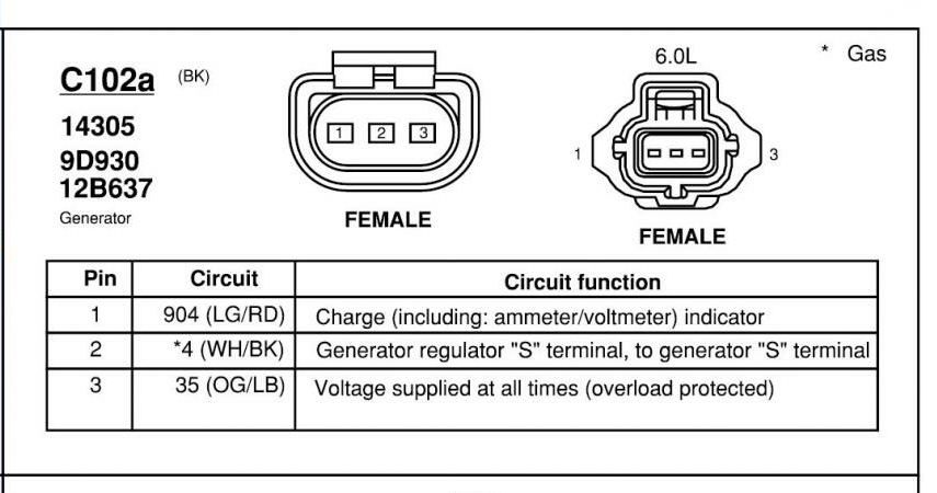

Hey guys,
Just replaced the alternator because of a battery light / no charge issue on the truck 3 days ago. It didnt solve the problem and I've been too busy to mess with it. Tonight, I tested the Alternator and got a reading of 10.5 volts out to the battery so I went a traded it for a new one. The problem is that it ripped my pigtail wires out and now I dont remember which side the green and orange wires go to on the harness. Can anyone snap a picture of theirs really quick for me please?

Old Dec 8, 2016 | 10:11 PM

You are the man, thank you so very much!
