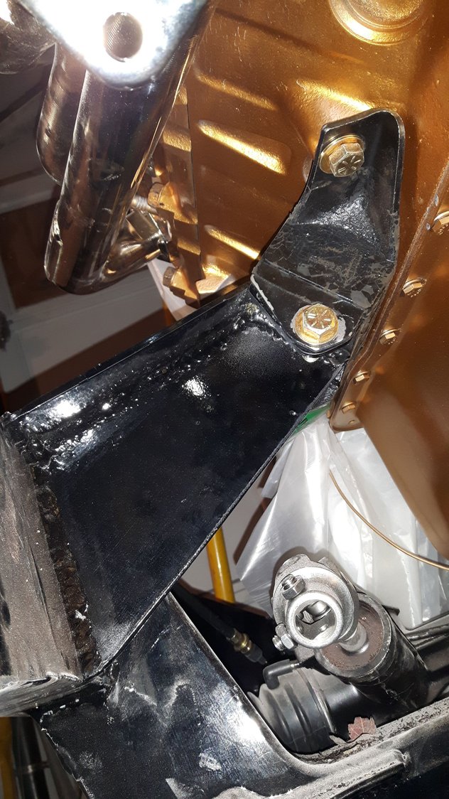

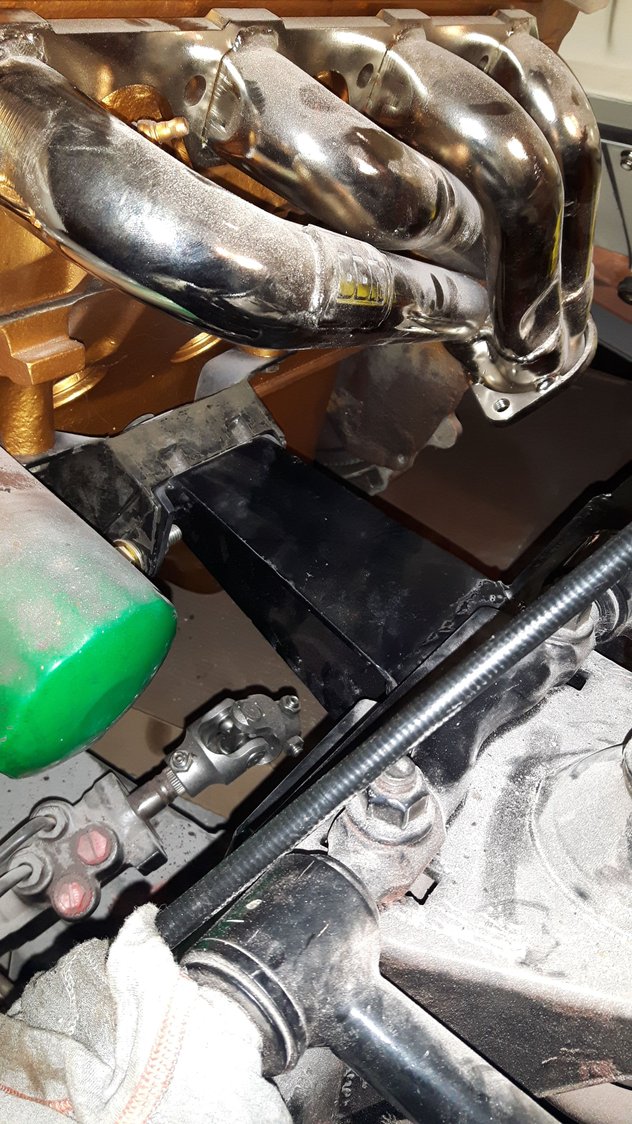

I did this in my 64. I put in a hiedts mustang 2. I have a 351w and c6 from a 1978 LTD. After I had my ride hieght set I put in the engine and transmission. Basically I set them in and blocked it where I wanted it to sit. A few things to keep in mind are that it will not be centered to the firewall because our firewall s are offset so don't be alarmed by this. It will look kinda funny at first. Also you will need to switch to a rear sump oil pan. I bought one from ford racing. I set my engine low and far back in the engine bay. I used welder series mounts. They came with the rubbers too. They are a cut and fit deal, then weld in place. If you need pics or anything just ask because my front sheet metal is still off so I could get decent pics

Pics
Left front
Left front. Taken from front
Left front. Pic taken from underneath

here's some pics of my motor mounts. Also. For a transfer crossmember they make a bolt in for a c6
