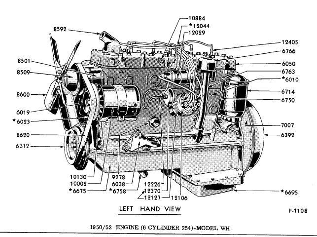

Originally Posted by ALBUQ F-1
Draft tube for 6 cyl?
MMM, probably not, doesn't look like any of the draft tubes I've seen on the 226's car or truck.
But it could be the refill hole pipe for the elusive steam wrench.
Tom

The base part number 6763 is for the pipe - engine oil filler. I don't have this number in my Canadian parts books, as we only had the 239 V8 which was 8BA 6763.

Like said the 6763 is an oil fill tube. A 0BA 6763 is the tube for a 226, 254, and 239 engine. But the -a suffix isn't listed in any of my old paper chassis catalogs or OSI catalogs. The 0BA 6763 was a number change from 7HA 6763. If Bill sees this can he add insight on the impact of the suffix in situations like this? Stu

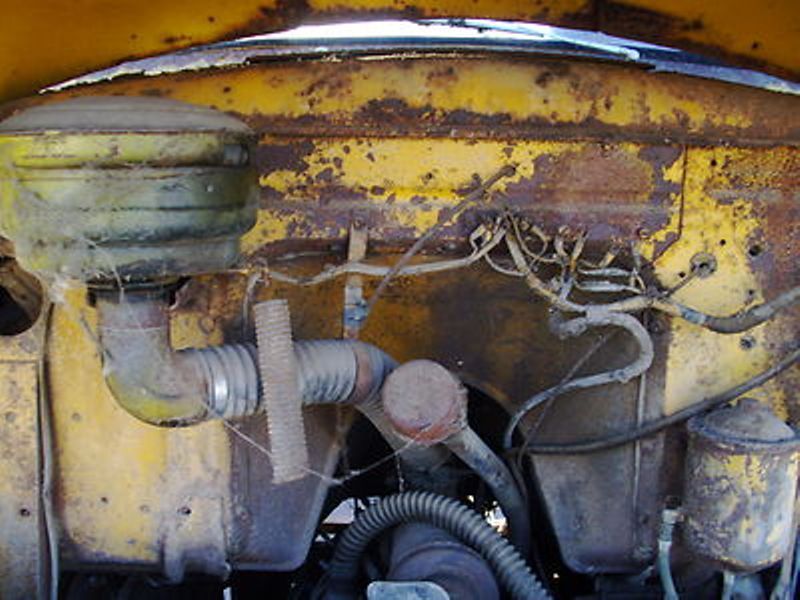

Old Dec 7, 2016 | 09:17 PM
ALBUQ F-1's Avatar
ALBUQ F-1
Joined: Jul 2004
Posts: 27,283
Likes: 1,046
From: NM
This looks like it, a COE with V8. You can make out the brace to the air cleaner. Almost looks like you put a regular V8 filler into the top of it?
edit, nope; found a better pic of the COE filler
